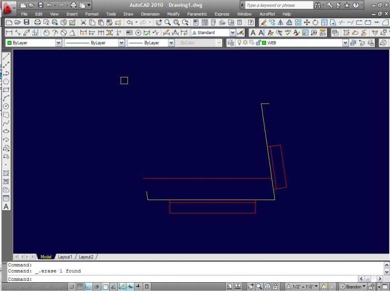

okay so i would start with something like
(defun c:str ()
(setq ris (getdist "\n Riser Height?="))
(setq pt1 (getpoint "\n Pick Starting tread.="))
and in between i would define my functions right?
 (command "_pline" "")
here's a quicky, maybe it will help you get started
(defun c:test ()
(setq hgt (getdist "\nEnter overall height: "); flr to flr distance
     stps (getint "\nEnter number of steps: ")
     rsr (/ hgt stps);riser height
     trd (getdist "\nEnter tread width: ")
     pt1 (getpoint "\nPick bottom start point: ")
(repeat stps; repeat the pline command as many steps you have
 (command "pline" pt1 (setq pt2 (polar pt1(/ pi 2) rsr)) (setq pt3 (polar pt2 0 trd)) "")
 (setq pt1 pt3); new start point for pline
Okay, I see how it works but when i try and make it draw the way i need it to i just screw it up and have to start over. This is very complicated trying to get it to draw the pans and angles and fill. Ill keep tring though
It helps to plan it out on paper first in plain words and write out any math equations that will be used.

I understand, and for the most part i think im trying to see and do too much i just can figure out how to make it draw what i need. Like this point to this point and angle and keep this as a constant. I guess its just going to take alot of time. Wish the ran DSL out at my house. cant get much help with dial up.

ok so this
I understand not what i cant figure out is the calculations to draw this

Here is what I would do;
In AutoCAD draw one out completely top floor to bottom floor.
Now dimension it
Make note of what is variable and what is consistent
List all of the math I need to figure it out
List all of the questions to ask the user to input
Are these always steel stairs?
From your drawing looks like a zig-zag line with the tread pans below the line and the riser pans behind the line. Am I correct?
I looked at the drawing you posted and it would help if you post a real scenario of a complete top to bottom drawing.
In one of the post you said all treads are 11” and risers are between 7” – 6 3/8”
Is the back angle always the same?
If this is correct you should be able to write a formula to calculate all needed distances
Your last post is of one step. Is that all you need?
If not you need to first look at the whole picture and quit focusing on the one step.

Now back to my sore thumb. I will go over it tonight and write down what i need. I think i know but i cant seem to understand how to make the formula with the numbers in the right syntax.

Assuming the angle from vertical of the riser is 15 degrees...(or 105 degrees)
the length of the riser would be (1/SIN 105 degrees) * riser height
this now includes an angle to the riser
(defun c:test ()
     angr (dtr 105); returns 105 degrees in radians
 (command "pline" pt1 (setq pt2 (polar pt1 angr (* (/ 1 (sin angr)) rsr)))(setq pt3 (polar pt2 0 trd)) "")
(defun dtr (a) (* pi (/ a 180.0)));function to convert degrees to radians
of course this doesn't include the pans, but it should give you some ideas...

how about this? it is only 4 but 11 (your constant) is no problem.
