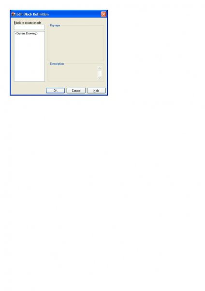

I may be repeating what you already know, but when I create a block using WBLOCK, then I open that drawing from wherever I saved it and use the BEDIT command. This brings up the dialog box below. Then I just select and it goes to Dynamic Block Editor.
Before saving and inserting (or redefining) the block I always use the Test Block Button at the top left of the Dynamic Block Ribbon to ensure it is working correctly.
