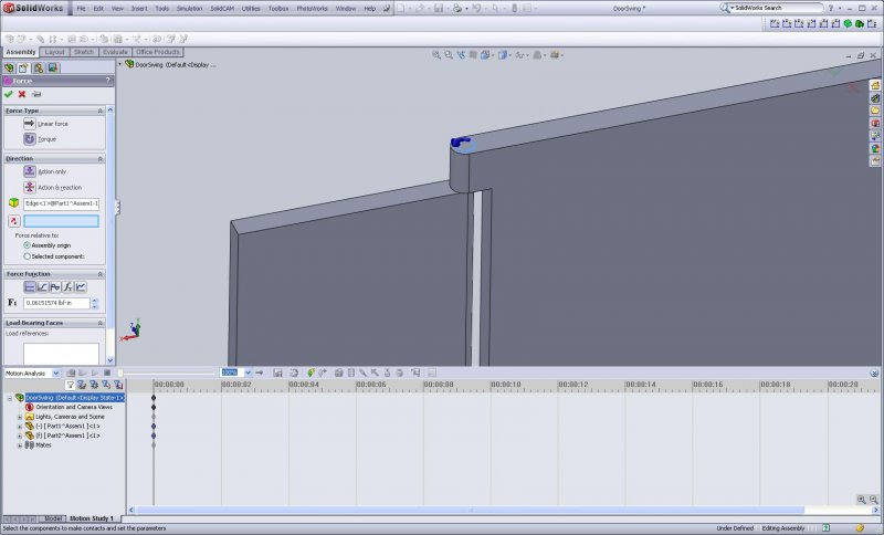

shift1313 Posted October 1, 2010 Posted October 1, 2010 Is your assembly setup properly first off. Meaning can you manually swing the door? In your motion study have you changed from Animation to Basic motion or motion analysis? Where was your motor applied? In this case its probably better to use the force and under force type select torque. This will allow you to setup a force function. You also may need positive stops on the door if you want to limit its motion or put damper on it. When applying a torque you need to be careful of your selection. If you select a face(top of door) it will apply it to the center of the face. You will want to select an edge at your hinge. If your hinge and pin have zero clearance you will want to Right Click and use the Select Other dialog in order to get the correct edge. Click to see video. Quote

shift1313 Posted October 1, 2010 Posted October 1, 2010 here you go bill. its 2009 format so the original poster wont be able to open it. As a side note i have 2010 for my home computer finally now that 2011 is out:) DoorSwing.zip Quote

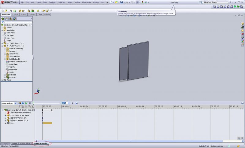

bhamze Posted October 1, 2010 Posted October 1, 2010 Thanks Matt, I cant seem to activate motion study with your part. Im able to click the tab but the motion study window does not appear. Strange, I'll keep trying. Hows 2010 treating you? Quote
shift1313 Posted October 1, 2010 Posted October 1, 2010 I havent used it yet:) just got the cd last night. Is there a Motion Analysis tab at the bottom? Quote
shift1313 Posted October 1, 2010 Posted October 1, 2010 Here is a thought for you bill. Go to Tools>add-ins and make sure you have Solidworks Motion Active. Quote
bhamze Posted October 1, 2010 Posted October 1, 2010 no tab, no add in available. What suite of SW are you using? Im using professional. Quote
bhamze Posted October 1, 2010 Posted October 1, 2010 I think that feature is only available in SW premium. Quote
shift1313 Posted October 1, 2010 Posted October 1, 2010 Im using premium. I thought it was in pro and premium but I dont know that for sure. Im not sure if they changed the name for 2010. In 08 they were referred to as cosmos, then 09 changed to Xpress. Maybe its something else now. If you right click near your tool bars like you are going to add another tool bar there is a Motion Manager you can turn on. This will toggle the motion study tab on/off, but if you already it I would expect that to be on. Quote
