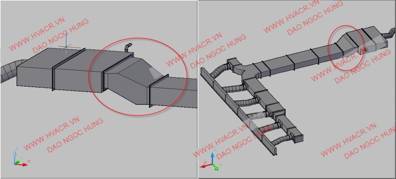

You should use Revit MEP.
I am using Revit to resolved my daily work.
It is very effective.
Video "MEP system - Modeling by Revit MEP & Walkthrough by Naviswork":
http://www.youtube.com/watch?v=NTLJj6vopiM
Video "Chiller Room - Modeling & Walkthrough by Revit MEP"
http://www.youtube.com/watch?v=x9tOHNTPRak
Video Tutorial Revit MEP 2010, Dao Ngoc Hung, ME Engineer. Download here
http://hvacr.vn/revit/clips/Duct%20Layout%20-%20Manually.flv
wol_error.gifThis image has been resized. Click this bar to view the full image. The original image is sized 1423x760.1.png
wol_error.gifThis image has been resized. Click this bar to view the full image. The original image is sized 1423x760.2.png
Edited by daongochungbk
