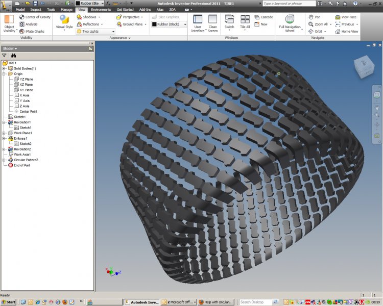

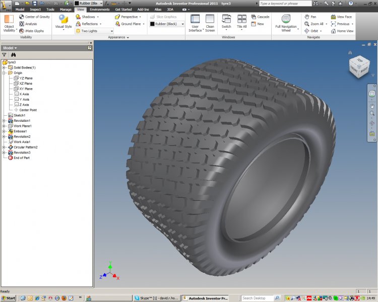

Ah!- I see. However, you haven't told me if my image is what you want to achieve and if I am correct in my assumptions?
If it is, there are several courses open to us - I could send you the file as is, with an explanation as to what I have done. Or you could post the underlying tyre profile and I will comlete it for you and send you a finished file.
In the attached picture I have just extrapolated the tyre profile from "sketch 1" and made it a uniform 6mm thick - I have no idea if this is correct or not?
If you want to do the work yourself you will have to make changes to the tread profile sketch, which I can outline. There is a problem with the dimensions as you already know (indicated by the sketch being pink). Unlike JD I don't subscribe to the rigid rule of dimensioning and constraining everything and I did not hesitate to remove the offending dimensions for expediency.
Just let me know what you want to do?

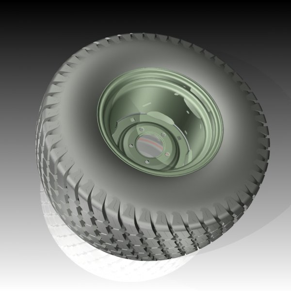

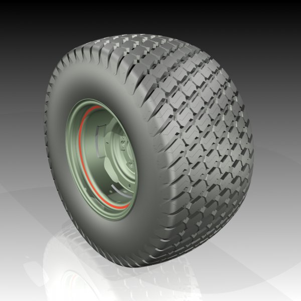

The finished tyre.
Edited by Hopinc
It's funny, but tyres always do look good.
It is actually not as complete as I would have liked - the tread now has draft, but it does not have bottom rounding. Unfortunately Inventor cannot pattern radii so it would mean that every tread block would need filleting independently. Not something I wanted to do, or that Alan thought was necessary for the use he had in mind. His original tyre was deflated but the customer decided that he wanted it inflated, so it looks somewhat different to my first offerings.
