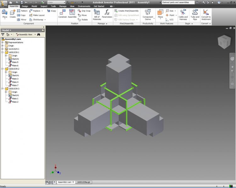

sight Posted October 5, 2010 Posted October 5, 2010 I created a sketch in Inventor based on a Standard(mm).ipt template. I would like to use this sketch into an assembly file (.iam) but to extrude them with different lenght. A simple sample: The sketch is a rectangle. I placed this sketch into the assembly file with two or more copies. The sketches are represented into the browser. I would like to add 50mm extrude for the first sketch and 100mm extrude for the second one and so on different extrude lenght for the others. When I extrude one of the sketches all the placed copies have the same lenght. Please give me your suggestion how I could add different lenght for the same sketch in the assembly file. In fact this sketch is more complicated than a rectangle so I don't want to create multiply sketches. See the attached file as an sample. Quote

Hopinc Posted October 5, 2010 Posted October 5, 2010 You might find that derived parts are a good solution. Look up "Derived parts and assemblies" under the Inventor "?" on the uppermost top right of the ribbon bar. Regards. Dave Quote
sight Posted October 5, 2010 Author Posted October 5, 2010 I made a sketch as a single part (*. ipt). This sketch is represent the cross section of an aluminium bar. I have to create an assembly file (*.iam) where I have to use a nylon corner (see in the attached picture) to joint the different alu bars. I put the sketches in the nylon corner using constrains. After I placing the sketches I would like to extrude them with different lenght. Finaly I have to create a box form alu profiles which has different lenght, height and width. I am new in Inventor before that I used AUTOCAD. Before a cross section of the alu bar is constant I created a single file. I want to use this cross section sketch with different lenght in same assembly file. Reading the aboves I hope that you can share the steps to achive the proper result. Quote

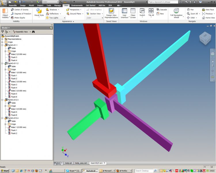

Hopinc Posted October 5, 2010 Posted October 5, 2010 iParts will do what you require. Unfortunately I hesitate to go into this until you have more experience with Inventor. Can I suggest that you do one of two things - Get hold of a copy of "Inventor 2011 Essentials Plus" book or see if you can find a tutorial for iParts on line. The latter is probably best. I created the attached assembly using a simple iPart I nocked up, and as you can see iPart allows me to change selected parameters (length in this case) when the part is brought into an assembly. Invidual lengths can also be modified at any time within the assembly. You can also see that I have been able to change things like materials and colours. Upon saving the assembly, iParts creates each part with a unique tag and stores all the variants you have created in the particular working directory you are in, so you can call them up and re-use them again if you wish. Regards. Dave Quote
rdharvey Posted October 5, 2010 Posted October 5, 2010 good solution, thought he would have been better creating individual parts though with it being the first time of using inventor. i like the i part function though its pretty handy stuff, although ive not delved into it too much as ive not long been using inventor. i used SW and pro E prior to my new job. how are the parameters changed within the assembly? also does this mean it will create new part files for the altered geometric parts? Quote
