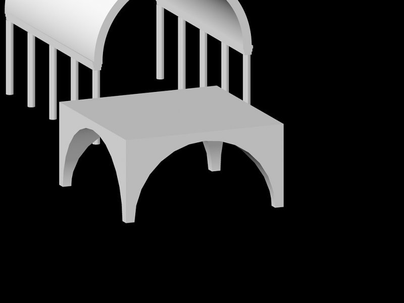

My problem is, that when I export my dwg to 3ds max, or I simply render the scene, my edges are like this, however, they should be round:
How could this be fixed?

the linked image is an autocad render.
In 3dsmax its even worse. Autocad displays smooth edges, only the render is not soft
I assume you're talking about the facets on the arch?
In Autocad, adjust your FACETRES variable to smooth the arc. You may need to Regen after changing this setting.
The problem in Max is that you don't have your Import options set correctly. Change your "Maximum Surface Deviation for 3D Solids" to .01.
