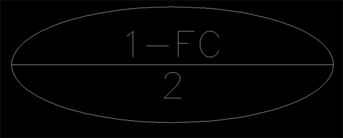

dealtrox Posted September 24, 2008 Posted September 24, 2008 HYEEE.... I NEW GUY IN THIS FORUM.... I HAVE ONE PROBLEM TO CREATE ATTRIBUTE... WENT I TRY TO CREATE NEW BLOCK CODING..IT'S CANNOT HAPPEN WHAT I WANT... I GIVE ONE JPEG FILE N DRAWING ...BUT THE CODING OK...EXACTLY WHAT I WANT U CAN SEE THE PROBLEM PLEASE.... SOMEONE PLEASE SOLVE THIS PROBLEM ATT PROB.dwg Quote
nocturne00 Posted September 24, 2008 Posted September 24, 2008 Yourquestion is a bit vague. from what u want to happen u just want to exchange the attributes positions in the block? or in the dialog box? use BATTMAN to arrange the order of the attributes in the dialog box. as for the exchanging the positions of the attributes just BEDIT the block Quote
dealtrox Posted September 25, 2008 Posted September 25, 2008 thank guy..... my problem settled already..... thank.....:shock: Quote
