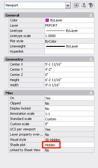

jessamy Posted September 15, 2008 Posted September 15, 2008 I am new to AutoCad 2008 and cannot seem to get the settings right (in either the camera named view or the viewport properties) in order to remove hidden lines from a 3D model and produce a good quality line drawing using my plot style pen settings. Either all the lines plot in their screen colors (and seemingly random lineweights) or I can plot a wireframe with no hidden lines. Any clues? Quote

jessamy Posted September 16, 2008 Author Posted September 16, 2008 if the lines are hidden, why do you need to remove them can you give me some insight as to the type of drawings you are working with? are we talking about plotting elevation terrain maps? certain types of objects? Do you need to plot in color or black/white? I am working in a 3d model of a room (and courtyard outside) but I don't want to create a 'shaded' drawing. I would like to create a simple perspective b&w wireframe line drawing with all the hidden lines removed and the lineweights plotted according to the plot style - just like I used to do in AutoCad 2005! 2008 does offer a '3D hidden' option but it plots according to screeen colour and the lineweights come out very lumpy and inconsistent. Quote

jessamy Posted September 16, 2008 Author Posted September 16, 2008 I currently assign lineweights to screen colors. However, I did try changing the relevant layers to black and assigning a lineweight to the layer instead - no change to the plotted line quality however. When searching in AutoCad help i did stumble across a reference to plot styles not being used when in 'shade mode', and I believe 3D hidden is a shade mode. I will try monochrome.ctb though Quote
jessamy Posted September 16, 2008 Author Posted September 16, 2008 Didn't work. The plot lines were still coloured and lumpy in monochrome.ctb. I would really love to know what your settings were on the plot you did - was it a named view? There seem to be 2 places to adjust 'view' settings - within the named view and within the properties of the viewport. Quote

Cad64 Posted September 16, 2008 Posted September 16, 2008 When searching in AutoCad help i did stumble across a reference to plot styles not being used when in 'shade mode', and I believe 3D hidden is a shade mode. That's true. Shademode does override CTB. So try this: I assume you are plotting from paperspace? Select your viewport and then, in the Properties palette, change the Shadeplot setting to Hidden. Quote
