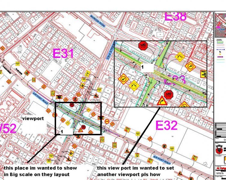

afrazawan Posted October 9, 2010 Posted October 9, 2010 pls i need help in view port im want to set on another view port on the same view port how can pls help me see detail image Quote

afrazawan Posted October 9, 2010 Author Posted October 9, 2010 DEAR MY post is that how can if in layout we need to show one spical place(see above picture) in large scale in layout how can we show that part of drawing in full layout i want to show one spical place in layout big scale how can but 1st see above image carefully then reply ok Quote

ReMark Posted October 9, 2010 Posted October 9, 2010 Here is a possible solution as suggested by AutoDesk itself and posted on its website. It uses a circular viewport over a much larger rectangular viewport but I don't think the shape matters at all. It could be another rectangle like you pictured in your image or it could be a 6-sided polygon. Read and try. Then get back to us with your comments. Become part of the solution. http://usa.autodesk.com/adsk/servlet/ps/dl/item?siteID=123112&id=5565685&linkID=9240615 Quote

CyberAngel Posted October 11, 2010 Posted October 11, 2010 I do this type of inset viewport on a regular basis. Here's my (possibly clunky) scheme. Draw a rectangle around the inset area in model space. That will serve as the visible border on the main plan and as the boundary for the inset viewport. Put it on a layer that will be visible in the main plan, but don't dress it up yet. In paper space, trace over the rectangle you just drew in model space. If it needs to be a larger scale, as yours seems to, then scale it up by the ratio between the plan and the inset. For instance, if the main plan is 1"=20' and the inset is 1"=10', that is a 2:1 ratio. Now the tricky part. Go to the View menu, open Viewports, pick Object, and select the rectangle. Go into model space to line up the first rectangle with the second rectangle; they don't have to meet exactly at this time. You may need to turn off the main viewport to work with the inset viewport. Go back to paper space. Set the scale for the inset viewport. It helps to lock it once you set the scale. With the plan viewport on, drag the corners of the inset rectangle to match the corners of the plan rectangle. Move your inset to its new location. Now you can add the annotation. Quote

qball Posted October 12, 2010 Posted October 12, 2010 maybe this will help if he sees the objects with the commands written down as well. Top one is as ReMark posted from autodesk. Bottom one is probably similar to CyberAngel's. Also for accurately placing viewport you can use Defpoints Layer and CHSPACE command to help. Drawing1.dwg Quote
