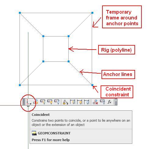

Alternately use parametric constraints (I think 2010 has them?) Make sure your square is a polyline so it moves as one object, then draw another temporary polyline around your anchor points. Place a coincident parametric constraint at the end of each anchor line by selecting the "Coincident" constraint and using the autoconstrain option within the command to select the rig, the temporary anchor frame, and all the anchor lines (or you can place them each manually) Now when you move the square, all the anchor lines will remain attached to it. see attached.

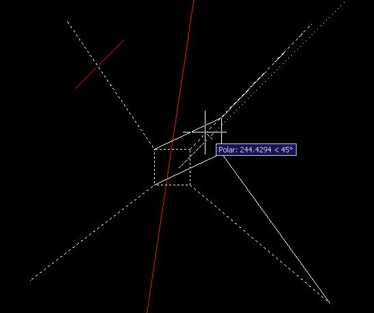

Thanks guys. Still having the same problem. Here are some screen grabs to illustrate it.

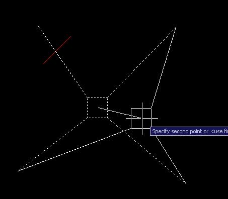

Screen Grab 001.jpg: The basic concept working. Rig and anchor lines in white, pipeline in red. I can stretch and drag the rig around no problem.
Screen Grab 002.jpg: The same as above but with a pipeline passing under the rig. When I try to stretch, one side of the rig stays in the same place.

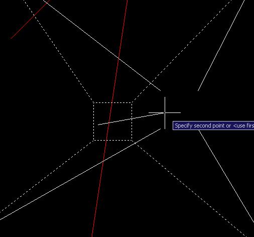

Screen Grab 003.jpg: The rig is now a block and not a rectangle as in the previous 2. The problem now is that the rig does not come with me when i stretch.

In the last screen shot, it looks like the square is with you, but you just can't see it. Try changing the "dragmode" variable.

In the last screen shot when I released the square it was not with me. It stayed in its original position.

Hmmm.. using "R" to remove the objects you didn't want to move/stretch should have worked. Here's the parametric example in my screenshot if you want to play with it. Use MOVE and select only rig to move it around, or you can simply drag the rig around with your mouse, just don't pick on a grip or it will "stretch" the rig.
*edit* grrrr I can't get the parametric constraints to save with the file? .... attachment removed.
**edit* re-upped

I selected everything in the drawing and then Shift-Clicked the items I didn't want to stretch. The rig and anchor lines moved like I wanted them to, passing over the pipeline without any of the warping in the earlier screen grabs.
In the screen grab it looks like the rig isn't there but it is. It was flashing on and off(crap graphics I guess:D ).
