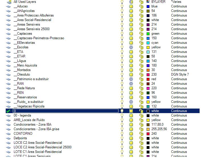

paulosalvado Posted October 12, 2010 Posted October 12, 2010 Hellow cad gurus Please tell me if there is a way (fast one ehehehe) to convert all layers in independat dwg keeping the name of the layer in the drawings that were created. many thanks Paulo Salvado Quote

BlackBox Posted October 12, 2010 Posted October 12, 2010 I believe this can be done with Visual LISP easily. If you can provide some additional information, such as the naming convention you want (i.e., format... "_.dwg"), and where you want the drawings to be saved (i.e., the same directory as the source drawing), that would be most helpful. Quote
paulosalvado Posted October 12, 2010 Author Posted October 12, 2010 Hellow Again Tiger sorry but has nothing to do whit layouts but thanks any way Renderman i made a printscreen that is an example of the layers name. The name that is on the layer must be the same that is on file... Example layer name - 123456789 must create a dwg whit the name 123456789.dwg The directory could be the same of the original dwg many thanks Paulo Salvado Ps sorry about my english Quote
Lee Mac Posted October 12, 2010 Posted October 12, 2010 I think I did something similar recently: http://www.cadtutor.net/forum/showthread.php?10359-save-each-layer-in-a-separate-file&p=358483&viewfull=1#post358483 Quote
