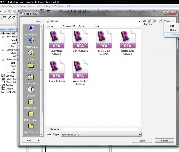

Hello,
I need some help with viewing my library components please..
I don't know why i can't see see the things, unless i click on every single thing of them...which i hate to do so..
Sorry if I'm unclear... i attached a picture, maybe you guys can help..
many thanks..

open windows explorer
Tools
Folder options
View Tab
Uncheck, "Always show icons, never thumbnails"
That should do it
