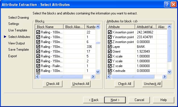

eldon Posted October 13, 2010 Posted October 13, 2010 If you go for the Attribute Extraction tool, that will tell you the numbers of the blocks and also the Insertion points. Quote

eldon Posted October 13, 2010 Posted October 13, 2010 Did you try the Attribute extraction tool? Just because the block does not have any attributes does not stop the number of blocks and their Insertion points being listed. Quote

ReMark Posted October 13, 2010 Posted October 13, 2010 I am completely embarassed. I forgot all about ATTEXT. What a dummy. I coulda had a V8! Thanks for jogging my memory. Quote
