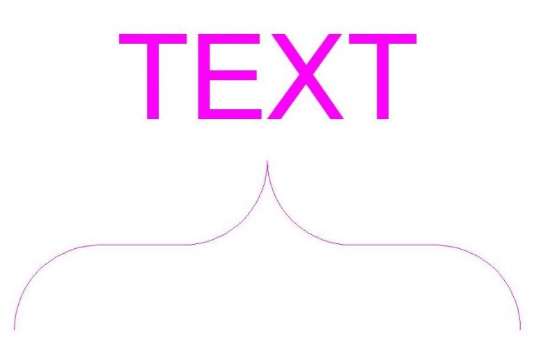

Hello Everyone,

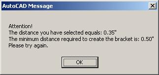

I am not sure this is of any use to you all, But I wanted to keep this thread simple. The attached code creates text brackets as pictured in the image. I have two codes posted, One for imperial units TBI and one for metric units TBM. There is an area at the beginning of the code for you to adjust your layer and font style. This code also has an error trap so that you do not create the bracket too small to avoid a deformed bracket drawn. There is minimum input required to operate it. You can enter the text you wish.
Enjoy the code.
