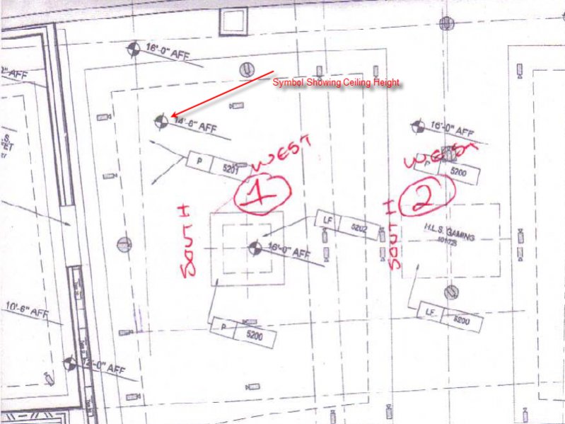

kencaz Posted October 17, 2010 Posted October 17, 2010 Here is the symbol for showing diff ceiling heights: This is commercial not residential, however there is probably a similar symbol for showing roof and ceiling heights in residential plan views... Yes, please post anything you find... KC Quote
