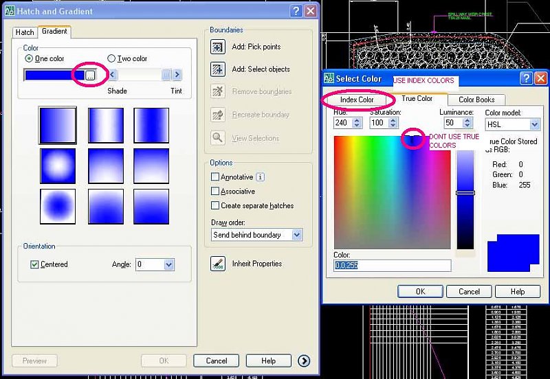

nocturne00 Posted September 17, 2008 Posted September 17, 2008 Check out the image. True colors wont print in monochrome (based from my experience)and the default color in the gradient hatch is a true color. replace it with an index color instead. Quote

nocturne00 Posted September 18, 2008 Posted September 18, 2008 So your problem still persists? Changing from true color to Index color did not work ? Quote
