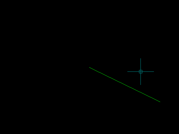

hi,lee,what I want to do is to drawing angle center line for two crossing lines.as the picture described.
If you are looking for 2 LINEs only, then this may work:

Just for fun :)
(defun c:bisect ( / _GroupByNum _inters _Circle _Line e o1 o2 ip c1 p1 c2 c3 li le gr cp lst ep )
 (vl-load-com)
 ;; © Lee Mac 2010
 (defun _GroupByNum ( l n / r)
   (setq r (list (car l)))
   (if l
     (cons
       (reverse
         (repeat (1- n) (setq l (cdr l) r (cons (car l) r)))
       (_GroupByNum (cdr l) n)
 (defun _inters ( obj1 obj2 )
   (_GroupByNum (vlax-invoke obj1 'IntersectWith obj2 acExtendNone) 3)
 (defun _Circle ( c r )
   (entmakex (list (cons 0 "CIRCLE") (cons 10 c) (cons 40 r) (cons 62 252)))
 (defun _Line ( p q )
   (entmakex (list (cons 0 "LINE") (cons 10 p) (cons 11 q) (cons 62 134)))
 (if (setq e
       (LM:Selectif
         (lambda ( x )
           (eq "LINE" (cdr (assoc 0 (entget x))))
         entsel "\nSelect Line: "
     (setq o1 (vlax-ename->vla-object e)
           o2 (vla-copy o1)
           ip (vlax-get o1 'StartPoint)
           le (vla-get-Length o1)
           c1 (vlax-ename->vla-object (_Circle ip (setq r (* 0.25 le))))
           p1 (polar ip (angle ip (vlax-get o1 'EndPoint)) r)
           c2 (vlax-ename->vla-object (_Circle p1 r))
           c3 (vla-copy c2)
           li (entget (_Line ip p1))
     (while (and (= 5 (car (setq gr (grread 't 13 0)))) (listp (setq cp (cadr gr))))
       (setq p2 (polar ip (angle ip cp) r))
       (vlax-put-property c3 'Center   (vlax-3D-point p2))
       (vlax-put-property o2 'EndPoint (vlax-3D-point (polar ip (angle ip cp) le)))
       (if (setq ep
             (car
               (vl-remove-if
                 (function
                   (lambda ( x ) (equal x ip 1e-)
                 (_inters c2 c3)
         (entupd
           (cdr
             (assoc -1
               (entmod
                 (subst (cons 11 (polar ip (angle ip ep) le)) (assoc 11 li) li)
;;---------------------=={ Select if }==----------------------;;
