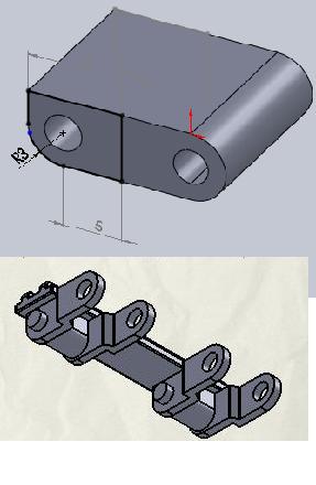

endlasuresh Posted October 21, 2010 Author Posted October 21, 2010 (edited) I need a 2d engg drawing from the file but it should be in pieces.from the image you see rectangle box which is in red color. I have to seperate this and then have to make 2d engg drawing for making this part.So please let me know how i should do this[ATTACH]24031[/ATTACH] Edited October 21, 2010 by endlasuresh Quote

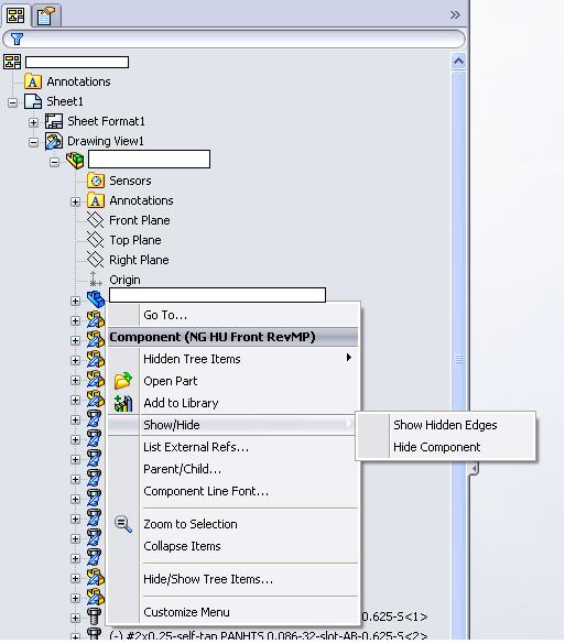

shift1313 Posted October 21, 2010 Posted October 21, 2010 When you are in a drawing if you expand that assembly file in the tree(left hand side) you can show/hide individual components by right clicking on them and selecting show/hide. Quote

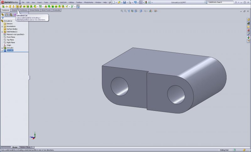

shift1313 Posted October 25, 2010 Posted October 25, 2010 Extrude cut(after you exit the sketch) is on the Features Tab(shown in the image below). Ive also attached a part file to show this. Are you having trouble within the Extrude-cut feature? ExtrudeCut.zip Quote

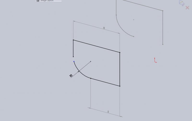

shift1313 Posted October 25, 2010 Posted October 25, 2010 I dont think I am understanding your problem correctly but from your screen shot there is a blue endpoint meaning it is under-defined. Were you able to open my file? Can you upload a zip of your file here so i can look at it? Quote

shift1313 Posted October 25, 2010 Posted October 25, 2010 end, your sketch is not valid for extrude-cut because its not closed. You need a closed profile in order to to extrude-cut. In the case of your sketch you can grab the blue endpoint of the arc and just drag it up until its coincident with the vertical line. I dont see a need for sketch 12 or 13. Part4.zip Quote
