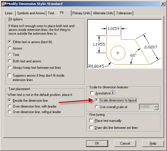

I don't understand why you would scale the "part", or scale the "titleblock, when you could just place the Titleblock in paperspace at full size and scale the view of the part. If you wanted to update the dimensions, just create one new Dimension style using Paperspace scaling and switch all the dimension to use that style.
