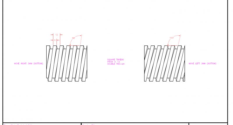

I am confused on how much to offset the bottom major/minor thread lines. It's SQ THD, P=12, DBL THD-LH.
I get confused on which way to move them and the direction. Is it half of the crest or half of the pitch? if it is half of the pitch, then it wouldn't matter the direction cause it's half... but the fact they're dbl threads and not single throws me off a bit.
Here is what im talking about in attachment:
