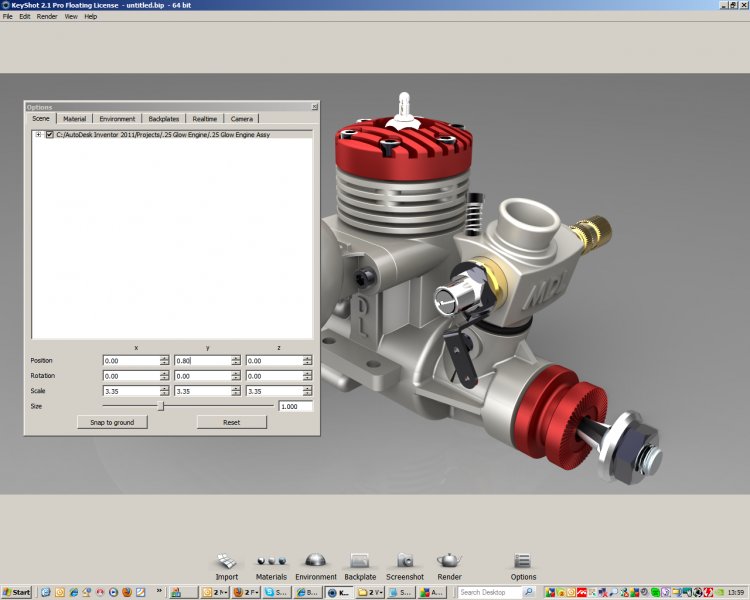

Unless materials have been pre-selected in your model/assembly, and you have ticked the required box to bring them into the rendering program, all models appear grey. It's a simple matter to drag and drop materials from the palette onto the model/assembly to put things right.
Once you have imported your model into either program you may find that it is facing the wrong way. It took me a little while to figure out how to change this, but these controls are found in the "scene settings." Once the model is selected by clicking on it in the drop down menu, it is possible to adjust it to your requirements (see the "Luxion" screen grab image).
Lighting is not controlled as in Inventor studio, rather it is a function of the "Gamma" and "Brightness" settings in the scene set up. What you get is greatly affected by your initial choice of scene and adjustments to it's height, rotation, etc. If a "backplate" is selected this will also affect lighting.
