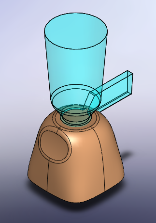

Dido Posted November 30, 2010 Author Posted November 30, 2010 I agree...the two point spline looks much better. I'm curious to see if this is part of a tutorial. If so, post here. Below is the download link for the Solidworks 2008 file: http://www.2shared.com/file/IK8IEpy3/mixer.html So, can anyone please tell me step-by-step tutorial of it? Thanks Dido Quote
shift1313 Posted November 30, 2010 Posted November 30, 2010 Im sorry dido but im not in the habit of downloading files. If you can give us more info, images, screen shots on why/what that curve is we can help you. Once you get to 10posts you can zip/attach files here that we can see. Quote
Dido Posted November 30, 2010 Author Posted November 30, 2010 shift1313 Im sorry dido but im not in the habit of downloading files. If you can give us more info, images, screen shots on why/what that curve is we can help you. Once you get to 10posts you can zip/attach files here that we can see. That link is the compressed file (WinRAR file) of the object .sldprt I’m asking for the tutorial. You can download it on the link I've post in my previous message. Quote
Dido Posted November 30, 2010 Author Posted November 30, 2010 Here’s the image of the entire object: Quote
shift1313 Posted December 10, 2010 Posted December 10, 2010 Dido, if you can upload your zip file here(once you get to 10 posts) I will look at this for you. I cant open your winrar file at work because of admin privileges needed. Also if you could let us know where the tutorial is located or the page in which this curve is described it might be easier to help you out. Quote
Dido Posted December 10, 2010 Author Posted December 10, 2010 Dido, if you can upload your zip file here(once you get to 10 posts) I will look at this for you. I cant open your winrar file at work because of admin privileges needed. Also if you could let us know where the tutorial is located or the page in which this curve is described it might be easier to help you out. It supposed to be on below link: http://www.solidworks.com/sw/support/807_ENU_HTML.htm It seems that the training file for SolidWorks 2008 has been not exist again. The only still exist are the training file for SolidWorks 2009, 2010, 2011. If I assume all of the training materials are same, only the version of the SolidWorks is different, then it should within the "Advanced Part Modeling", lesson01 folder. Quote
