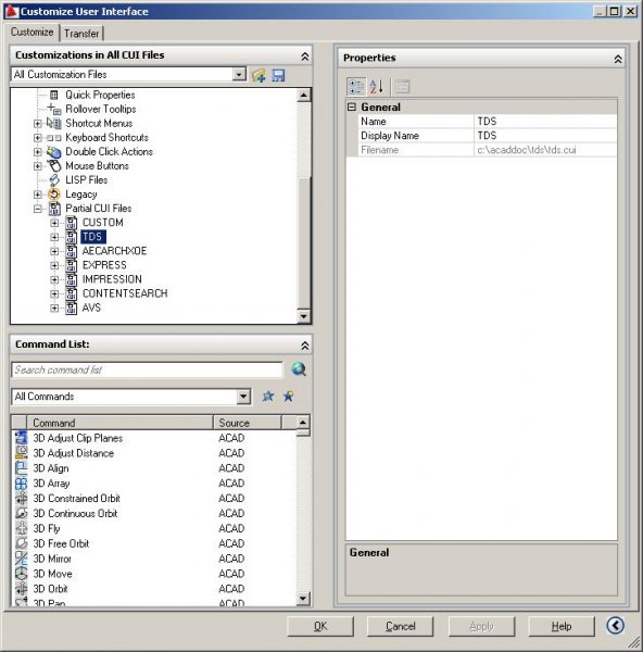

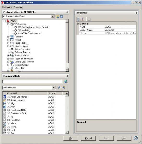

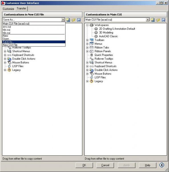

The Buzzard Posted November 4, 2010 Posted November 4, 2010 (edited) Hi, If you want to change menu name in .cui file.... Find menu group in cui file which is noted as ***GROUPNAME Below the menu group you can find the different menu names which are noted as **MENUNAME Changing this menu name can help you. Cheers, Thats not for a .cui file. Those belong to the old .mnu file from 2004 and back. You do your editing in the cui as shown below in the image. You should never rename any part of the original acad.cui unless you are looking for problems. You can add menus and customize them through the CUI. Refer to the AutoCAD Help Section before you do anything to your menus. If you want to bring in an old .mnu or .mns type file, You need to import it in through the CUI with _cuiimport command. This will bring up the CUI editor as shown in the image below. You can save it to the name you want by doing a Save As... as also shown below. You can place it where you want in your menu area. Before doing anything I recommend you make a backup profile in case you screw up and also refer to the AutoCAD Help File to have a better understanding on how to do what your looking to do. Edited November 4, 2010 by The Buzzard Quote

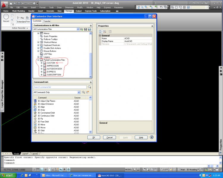

ReMark Posted November 4, 2010 Posted November 4, 2010 Personally this is where I think any customized menus should be inserted. Quote
The Buzzard Posted November 4, 2010 Posted November 4, 2010 Personally this is where I think any customized menus should be inserted. [ATTACH]24351[/ATTACH] Your right ReMark, Thats where I have my custom menus. Sorry if I did not go into enough detail, But I wish folks would look at their help file for once. All that information available gets ignored to often. Quote
