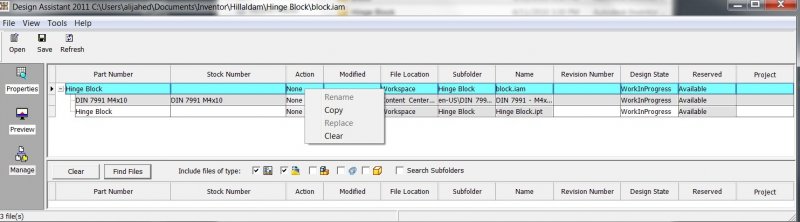

Untitled.jpgHi All,
Just want to say the name "Design Assistant 2011" has to be changed to "Design interrupter" or something like that!
I bloody spent 1 hour now to find out how can I rename a bloody file name!
This piece of software is really annoying $@#%$#%$%^:reallymad:
Don’t tell me go and right-click on the name and change it or double click on it and change it because it doesn’t work and if you coming with another solution I have to tell you “THIS IS BLOODY STUPID”!
I just want to know who wrote this bloody software…

I don't want to change the name of that DIN part at the moment. What I realized I can't change the name of the assembly file "the very top file" but I can change the parts!
The very top file does not require change in the Design Assistant. This you can change without the tool. The parts which have embedded links inside the Assembly require this because it will fix the links.
If you use the Copy option on the Assembly you can go to the Name field choose Edit to change the name and then edit it. But really this can be done in Windows without causing errors in the parts.

I don't like to change the name out of this piece of software coz this supposedly designed for these actions. When you use the "copy" option it simply copy another file so you end up with 2 files which is no good.

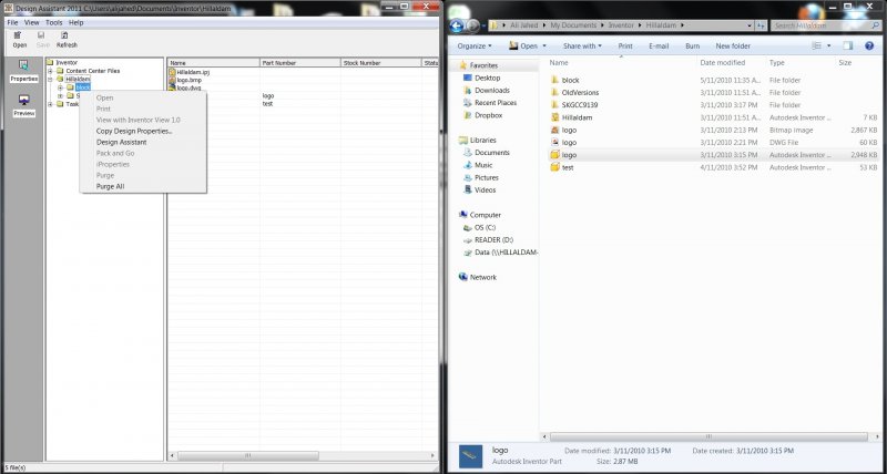

I found another stupid thing which is you can't change the folder name!
