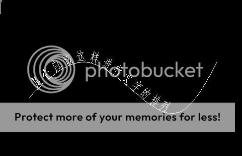

blueshake Posted November 4, 2010 Posted November 4, 2010 hi,all I search the forum,and lee has wrote a lot of routine for this. but I found that it seems it don't play this trick.see the picture. is there any lisp can play this magic?thanks. Quote

blueshake Posted November 4, 2010 Author Posted November 4, 2010 sorry,update the picture host now. Quote
Tiger Posted November 4, 2010 Posted November 4, 2010 So...what is it about your request that Lee's program can't do? Quote
Tharwat Posted November 4, 2010 Posted November 4, 2010 Use arctext command from Express menu . arctext Tharwat Quote
Lee Mac Posted November 4, 2010 Posted November 4, 2010 You can't with a single text item (without using the ArcAligned Text Custom Object from Express Tools), but I did experiment with the idea of using multiple items here: http://lee-mac.com/slinkytext.html Quote
blueshake Posted November 4, 2010 Author Posted November 4, 2010 So...what is it about your request that Lee's program can't do? in this site http://lee-mac.com/slinkytext.html ,it work now. Quote
blueshake Posted November 4, 2010 Author Posted November 4, 2010 Use arctext command from Express menu . arctext Tharwat arctext only work for arc,not any curve. Quote
blueshake Posted November 4, 2010 Author Posted November 4, 2010 You can't with a single text item (without using the ArcAligned Text Custom Object from Express Tools), but I did experiment with the idea of using multiple items here: http://lee-mac.com/slinkytext.html that is what I want ,thank you. Quote

blueshake Posted November 5, 2010 Author Posted November 5, 2010 hi,lee I test your codes.it is amazing. here comes my remark. can we arrange the string in average? e.g. I have a sting "ABCD" and I choose the curve (circle).then I may want to place them in average.see the picture.the same to any curve. anyway.that is just my thought. Quote
Lee Mac Posted November 5, 2010 Posted November 5, 2010 hi,leeI test your codes.it is amazing. Thanks! here comes my remark.can we arrange the string in average? e.g. I have a sting "ABCD" and I choose the curve (circle).then I may want to place them in average.see the picture.the same to any curve. anyway.that is just my thought. By 'average', do you mean equispaced along the curve? If so, one could retrieve the length of the curve, divide by the number of characters in the string to get the spacing, calculate the points for each character and the first derivative of the curve at such points, then position accordingly. Lee Quote
blueshake Posted November 5, 2010 Author Posted November 5, 2010 Thanks! By 'average', do you mean equispaced along the curve? If so, one could retrieve the length of the curve, divide by the number of characters in the string to get the spacing, calculate the points for each character and the first derivative of the curve at such points, then position accordingly. Lee yes. Lee,can you change your codes to do this if you are free?I don't have the ability to do this.:)thank you. Quote
