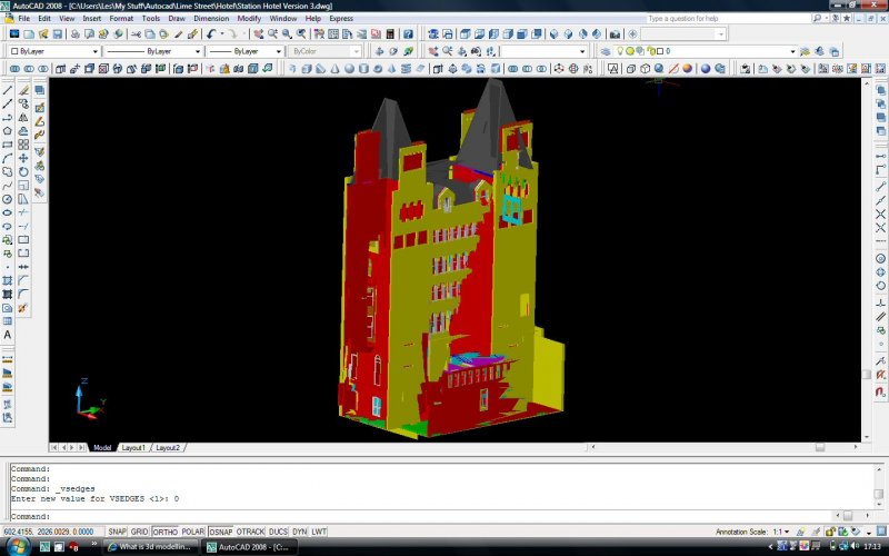

LGGreen Posted November 6, 2010 Posted November 6, 2010 I have a 3D model of an archictectural model of a hotel. The actual model is made up of layers of plywood, plastic etc of thicknesses of 2mm down to 0.25mm. Using Autocad 2008 the wireframe model is OK. When I change the viewing style to realistic visual style most of the coloured surfaces are incomplete resulting in a very broken image. I am using Windows Vista on a Dell Inspiron 1520 laptop with an Nvidia Geoforce 8600M 256MB graphics card. I suspect my hardware rather than Autocad itself, but I may be wrong. Quote

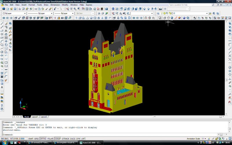

rvpas Posted November 6, 2010 Posted November 6, 2010 Hi LG Try 3dconfig in command line Clik on Manual Tune button and check Enable hardware acceration on the top of dialog box bye Pascal Quote
LGGreen Posted November 7, 2010 Author Posted November 7, 2010 Hi Pascal Thanks for that. It seems to work OK now, but a quick look at the autocad model shows the image breaking up if I zoom out a long way and then zoom back in. This is how the model looks now, and is how it should be. Les Quote
ReMark Posted November 7, 2010 Posted November 7, 2010 I'd say it was your graphics card not being up to the task. Quote

SEANT Posted November 8, 2010 Posted November 8, 2010 Due to view settings, a rather obscure issue can arise that produces anomalies similar to the image you attached to Post #1. See this thread as an explanation: http://www.cadtutor.net/forum/showthread.php?11995 If you can, post the file for examination. Quote
