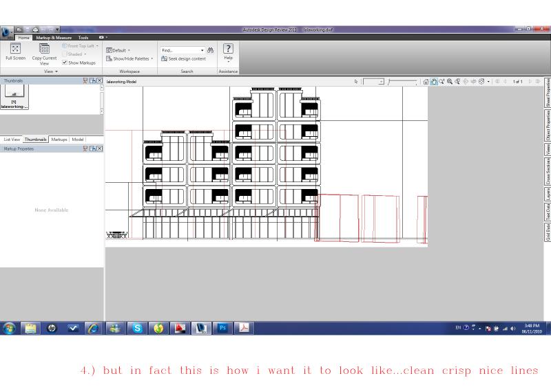

i want to export files with clean crisp nice lines... into jpeg or pdf,
but they turn out bold and blotchy..
also im not sure what to do with a long size drawing to export :(
please help thanks.. ive got images to help you understand the problem im facing..
THANKS!

yep i have.. how do u usually do it? does it have something to do with override? i donno what override is...
When you started exporting to pdf and you have the missgae box of (page setup ovverride), there is a small icon within Plot Style table it's called (edit)
so just cklick on that button and you'd have the list of colors or actually Plot Style Table and within that box you should adjust the Line Weight according
to the color and I am sure you'd get it worked very soon.
remark : try to get your drawing to pdf through the plotter which is I think is better than exporting. (by command print and by printer name : DWG to PDF).
