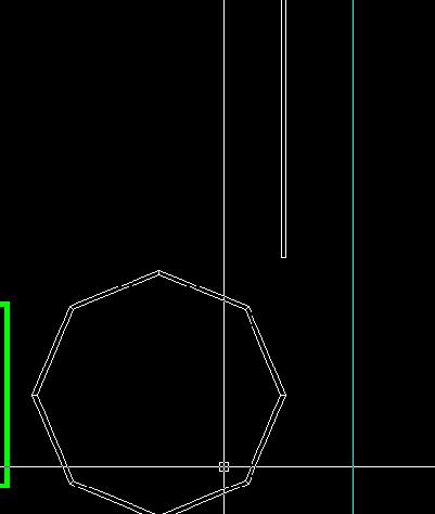

Hello, I seem to have a problem with a pline (title block outline). I have it set to a certain thickness and when I bring it in from another drawing it only draws the outline of the line.
The line shown should be solid but it is not.
Thank you
Set FILL to ON at the command line. Regen. What happens?
Nothing unfortunately it is still the same.
If I start a fresh drawing with my acad.dwg template and import the title block it seems to be fine.
Ok fixed the problem by fresh template and importing title block into the drawing then importing my drawing to it as well.
Would be nice to know what happened for future reference.
