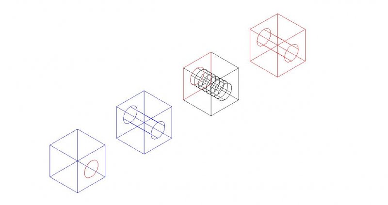

Here is an example of what I was talking about.
Re: previous image.
Lower left. Solid box with circle ready to be extruded.
Next. Solid box with extruded circle subtracted.
Next. Exploded box. I erase everything that is black in color and use PressPull to extrude the remainder.
Upper right. End result is solid box with hole.
