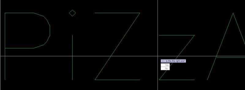

What about "PiZzA"?
Found it without a problem:
Command: find2
 >>  Enter Text to Find: z
 >>  There were 8 Matches Found... ._zoom
Specify corner of window, enter a scale factor (nX or nXP), or
[All/Center/Dynamic/Extents/Previous/Scale/Window/Object] <real time>: _object
Select objects:   1 found
Select objects:
Command:
 >>  Is this the right one? [Yes/No]: n

Command:
 >>  Is this the right one? [Yes/No]: y
Command: find2
Select objects:
Command:
._zoom

Command:
Command:
[ATTACH]24539[/ATTACH]
