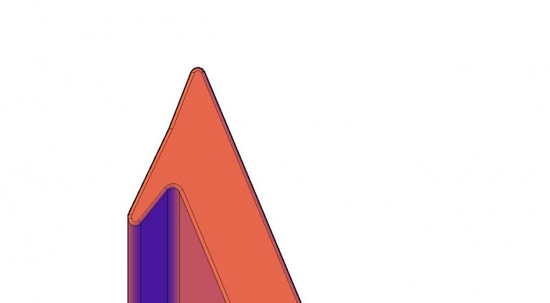

ReMark Posted November 15, 2010 Posted November 15, 2010 Remember...GIGO. Here is your letter after a bit of cleanup. The underlying linework was a mess. Way too many short line segements. gilbert[rev].dwg Quote
ReMark Posted November 15, 2010 Posted November 15, 2010 but i dont know how Look at the example I just posted. I cleaned up many of the short line segements, used the Pedit command to join all the new, longer segments, radiused them (R=0.5) and extruded. No one said it was going to be easy. If you start out with a better basis for your lettering you'll get a much better end result. Quote

ReMark Posted November 15, 2010 Posted November 15, 2010 sir these are the sides that i wanted to fillet [ATTACH]24601[/ATTACH] That won't happen as you probably have already found out. You'll get this as a response from AutoCAD: Failed to perform blend. Failure while filleting. It can be done in my example, gilbert[rev].dwg, however. Quote
ReMark Posted November 15, 2010 Posted November 15, 2010 A radiused edge. The size of the radius does make a different too. I had to use 0.25 as 0.5 would not work. Quote
ReMark Posted November 15, 2010 Posted November 15, 2010 After a bit more experimenting with your last sample drawing I was able to get some, not all, of the edges to fillet using a setting of .125 but I think you have too many inconsistencies in the construction of your solid for successfully filleting the entire top edge like you want. Quote
