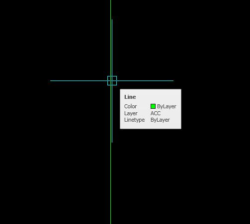

Lt Dan's legs Posted November 22, 2010 Posted November 22, 2010 like this? image above from architecture 2010 Quote
Lee Mac Posted November 22, 2010 Posted November 22, 2010 Something similar to this? http://www.theswamp.org/index.php?topic=33078.0 Quote
giskumar Posted November 23, 2010 Author Posted November 23, 2010 Yes Dan's I am looking for the same. Thanks & Regards, Kumar. Quote
