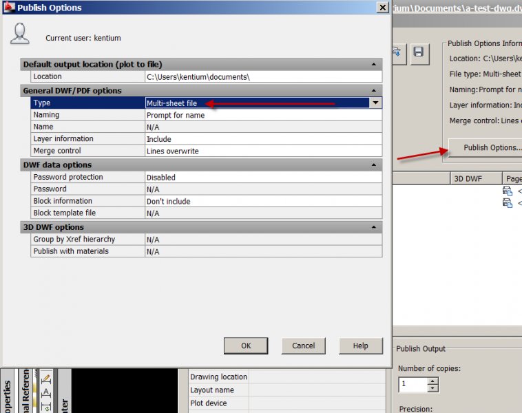

In 2010 you can Publish to PDF as a multi-sheet pdf. I don't know about 2009 though. I skipped that version.
Use multi-sheet option in Publish, it is in 2011 so hopefully it is in 2009.
