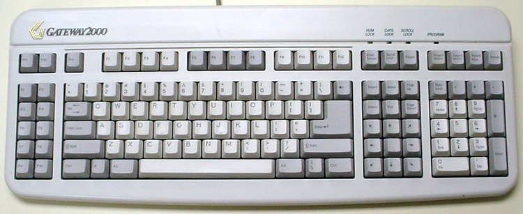

alanjt Posted November 30, 2010 Posted November 30, 2010 I use the Gateway2000 Anykey keyboard - circa 1994. I have most of the left side additional F* keys programmed to be OSnap overrides and the others just a couple custom popup menus. Quote

ColinPearson Posted November 30, 2010 Author Posted November 30, 2010 Also, that keyboard looks like something I need! Quote

alanjt Posted November 30, 2010 Posted November 30, 2010 Also, that keyboard looks like something I need! I love mine - had it forever. Check eBay for them. I also use this: http://www.xkeys.com/xkeys/xkdesk.php However, they were a lot cheaper when I purchased mine. Quote
