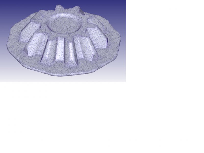

JPlanera Posted November 30, 2010 Author Posted November 30, 2010 It is a forging simulator called DeForm. The simulation would work in any orientation, however, the data results plot more clearly and are understood better if everything is "real world" Quote
Hopinc Posted November 30, 2010 Posted November 30, 2010 I didn't know there was any such thing as a forging simulator - but then again, why shouldn't there be! Thanks for the explanation. Good luck, Dave Quote
JPlanera Posted November 30, 2010 Author Posted November 30, 2010 Yes it is quite an amazing product. I have seat here and it is astonishing how close to reality it is. You are right! Nowadays there is a software program for everything! Thank you for the help Quote
