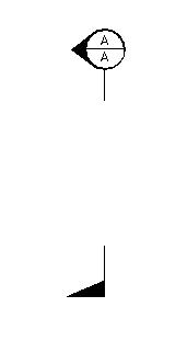

matthewrussell Posted September 22, 2008 Posted September 22, 2008 Please see picture attached first. Ok here it goes. I am trying to create a lisp routine that will work for that. What I am trying to do is make It out of 3 Blocks. 1st: Top Arrow and Top vertical line 2nd: Circle with horizontal line 3rd: Bottom arrow with bottom Vertical line I am using AutoCAD 2009. So these blocks will be drawn at scale 1:1 but be made annotative when I block it. So when inserted say at 1:10 it will be at the correct sizing... (scales in metric system) However Blocks 1 & 2 would be in the same DWG and block 3 will be in a second dwg. This is because I want 1 & 2 to clearly be inserted at the same co-ords in the drawing. So that is what I am trying to do but this is what I am having trouble on. Once I select the first point I want it to use like a ortho/polar thing from that first point. So that when the section mark is drawn in it will be aligned with the 2 points you selected. What is also giving me trouble is that how do I make it aligned and how do I make the arrows of the section be perpendicular to either side but you have to choose the direction they face. So if you draw the section horizontally and you wanted the section to look up vertically all you have to do is click to the top of the line u drew and the section arrows will face that way. And that applies if i clicked down i want the arrows to face down. I know something like this is possible cause I have seen blocks like this in use. I am only a beginner at this lisp routine stuff so help will be greatly appreciated. Or if someone has already doen something like this can I possible get your coding so I can see how you did it. I have also copied in some of the coding I have done for it. (defun c:insert-secttop-block (/ layerset) (setq layerset (getvar "clayer")) (setvar "clayer" "35") (setq scaleset (/1 (getvar "cannoscalevalue"))) (setvar "ATTDIA" 0) ;that last line is since I have attributed text in the block I dont want to eddit it now it will just go in as is. (setq ins-pt (getpoint "\nSelect Insertion Point: ")) (if (=nil ins-pt) (setq ins-pt (list 0 0))) That is it for the momment. But I think there is a easier way with the inserting points. Is there a way to name ins-pt1 and ins-pt2? So i can get those values and then just when I insert the block I can say for it to be inserted at variable ins-pt1??? Thanks for the help in advance Quote

matthewrussell Posted September 22, 2008 Author Posted September 22, 2008 For some reason when I run the command. It runs but just doesnt do anything. It doesnt come up with unknow command it just does nothing. Its puzzling me very much and Im trying to figure out why. Could it have anything to do with the version of AutoCAD I am running? 2009 ;---SECTION TITLE--- (defun c:insert-sectcall-block (/ layerset) (setq layerset (getvar "clayer")) (setvar "clayer" "35") (setq scaleset(/ 1 (getvar "cannoscalevalue"))) (setvar "ATTDIA" 0) (setq ins-pt (getpoint "\nSelect Insertion Point: ")) (if (= nil ins-pt) (setq ins-pt (list 805 553)) ) (command "-insert" "section title" ins-pt scaleset scaleset "0") (command "explode" (entlast)) (setvar "ATTDIA" 1) (setvar "clayer" layerset) (princ) ) ;defun That is the coding i was for my other blocks like the one shown in the jpg file. This is what I did but I didnt know what to do for the ortho and the direction of the arrows. ;---SECTION BUBBLE--- (defun c:insert-sectbub-block (/ layerset) (setq layerset (getvar "clayer")) (setvar "clayer" "35") (setq scaleset(/ 1 (getvar "cannoscalevalue"))) (setvar "ATTDIA" 0) (setq ins-pt1 (getpoint "\nSelect First Insertion Point: ")) (if (= nil ins-pt1) (setq ins-pt1 (list 805 553)) ) (setq ins-pt2 (getpoint "\nSelect Second Insertion Point: ")) (if (= nil ins-pt2) (setq ins-pt2 (list 805 553)) ) (command "-insert" "section bubhead" ins-pt1 scaleset scaleset "0") (command "-insert" "section bubarrow" ins-pt1 scaleset scaleset "0") (command "-insert" "section bubtail" ins-pt2 scaleset scaleset "0") (command "explode" (entlast)) (setvar "ATTDIA" 1) (setvar "clayer" layerset) (princ) ) ;defun Quote
russell84 Posted September 22, 2008 Posted September 22, 2008 SORRY I LEFT A LITTLE BIT OUT. Try this - let me know if it works. (defun c:SECTMARK () (SETQ $PATH "C:/Documents and Settings/");CHANGE THIS TO THE PATH THAT YOU PASTE YOUR BLOCKS TO. CHEERS (SE-erro) (SE-quiet) (SE-init) (Get_mvs) (pick1) (ask1) (setq #loc #org) ; ### Bubble Point (make-pts1) (setvar "attdia" 0) (command "layer" "m" "TAGS" "" "insert" (strcat $PATH "Sec-ball") #loc DMS DMS "0" #sectno #drawno "insert" (strcat $PATH "Sec-arr") #loc (* -1 DMS) DMS (rtd #ang) ); Arrow (setvar "attdia" 1) (setq TAIL "Sec-endB") (setq MIR nil) (setq MIR (getstring "\nFlip? Y/N <N>: ")) (if (/= MIR "")(setq MIR (strcase (substr MIR 1 1)))) (if (= MIR "Y") (progn (command "mirror" (entlast) "" #loc #2nd "y") (setq TAIL "Sec-endA"))) (COMMAND "-INSERT" (strcat $PATH TAIL) "_r" (rtd (+ (* pi (/ 180 180)) #ang)) "_s" DMS #LOC ) (COMMAND "UCS" "Z" (RTD #ANG)) (SETVAR "ORTHOMODE" 1) (princ "\nSelect base point to move section tail from..") (COMMAND "MOVE" (ENTLAST) "" pause PAUSE) (COMMAND "UCS" "P") (SE-normal) (setq *error* olderror) (princ) ) (defun dtr (a) (* pi (/ a 180.0)) ) (defun rtd (a) (* 180.0 (/ a pi)) ) (defun SE-init () (setq #45 (dtr 45) #90 (dtr 90) #135 (dtr 135) #180 (dtr 180) #225 (dtr 225) #270 (dtr 270) #315 (dtr 315) ) ) (defun pick1 () (setq #org nil #2nd nil #side nil) (while (= #org nil) (setq #org (getpoint "\nSelect Center point of Section Bubble: ")) ) (while (= #2nd nil) (setq #2nd (getpoint #org "\nRotation of Section mark?: ")) (if (= (getvar "orthomode") 0) (setq orno T) (setq orno nil) ) ) (setq #ang (angle #org #2nd)) (setq #dist (distance #org #2nd)) ) (DEFUN Get_mvs () (if (and (= (getvar "cvport") 1)(= (getvar "tilemode") 0)) ; if in Paperspace (setq dms 1) (if (= (getvar "tilemode") 0) ; if in Modelspace inside viewport (progn (vscl) (setq dms mvs) );progn (Try_Dimscale) );if );if );defun (defun ask1 () (if #sectno (progn (setq #prevno #sectno) (setq #sectno (getstring (strcat "\nSection Number <" #prevno ">: "))) (if (= #sectno "")(setq #sectno #prevno)) ) (progn (setq #sectno (getstring "\nSection Number <1>: ")) (if (= #sectno "") (setq #sectno "1")) ) ) (if #drawno (progn (setq #prevdrawno #drawno) (setq #drawno (getstring (strcat "\nDrawing Reference <" #prevdrawno ">: "))) (if (= #drawno "")(setq #drawno #prevdrawno)) ) (progn (setq #drawno (getstring "\nDrawing Reference <->: ")) (if (= #drawno "") (setq #drawno "-")) ) ) ) (defun make-pts1 () (setq #bb1 (polar #loc (+ #ang #180) (* DMS 17.0)));; Bubble Centre (setq #tp2 (polar #loc (+ #ang #90) (* DMS 15.0))) ;; Text Left (setq #tp1 (polar #2nd (+ #ang #90) (* DMS 15.0))) ;; Text right (cond ( (= #90 #ang)(setq #tang 0) ) ( (= #270 #ang)(setq #tang 0) ) ( (and (< #90 #ang)(> #270 #ang) )(setq #tang (+ #180 #ang)) ) ( t (setq #tang #ang) ) );cond ) (defun SE-quiet () (setvar "cmdecho" 0) (setq OLDOSMODE (getvar "osmode")) (setvar "osmode" 0) (COMMAND "UNDO" "GROUP") (setq angb (getvar "angbase") angd (getvar "angdir") orthom (getvar "orthomode") blipm (getvar "blipmode") ) (setvar "plinewid" 0) (setvar "blipmode" 0) (setvar "angbase" 0) (setvar "angdir" 0) (if orno (setvar "orthomode" 0) (setvar "orthomode" 1) ) (CURRENT_COLOR) (setq #CLA (getvar "clayer")) (setq #CLT (getvar "celtype")) (command "color" "bylayer") (command "linetype" "s" "bylayer" "") (command "layer" "m" "TAGS" "") ) ;;; Reset Values (defun SE-normal () (if blipm (setvar "blipmode" blipm)) (if angb (setvar "angbase" angb)) (if angd (setvar "angdir" angd)) (if orthom (setvar "orthomode" orthom)) (command "layer" "s" #CLA "") (command "color" #CCN) (command "linetype" "s" #CLT "") (COMMAND "UNDO" "END") (setvar "cmdecho" 1) (setvar "osmode" oldosmode) ) (defun SE-erro () (setq olderr *error* *error* SEerra)) (defun SEerra (s) ; If an error (such as CTRL-C) occurs ; while this command is active... (if (/= s "Function cancelled") (princ (strcat "\nError: " s)) ) (if blipm (setvar "blipmode" blipm)) (if angb (setvar "angbase" angb)) (if angd (setvar "angdir" angd)) (if orthom (setvar "orthomode" orthom)) (if #CLA (command "layer" "s" #CLA "")) (if #CCN (command "color" #CCN)) (if #CLT (command "linetype" "s" #CLT "")) (COMMAND "UNDO" "END") (setvar "cmdecho" 1) (setvar "osmode" oldosmode) (setq *error* olderr) ; restore old *error* handler (princ) ) (defun CURRENT_COLOR () (setq #CCN (getvar "cecolor")) (if (or (= #CCN "BYBLOCK")(= #CCN "BYLAYER")) (setq #cn #CCN) (progn (setq #cr (atoi #CCN)) (if (and (> #cr 0) (< #cr ) (progn (setq #CLIST (list "RED" "YELLOW" "GREEN" "CYAN" "BLUE" "MAGENTA" "WHITE")) (setq #cn (nth (- #cr 1) #CLIST)) ) (setq #cn (rtos #cr 2 0)) ) ) ) ) (defun Try_Dimscale () (if (or (= (getvar "Dimscale") 0)(= (getvar "Dimscale") 1)) (progn (initget 1) (setq dms (getint "\nEnter SCALE: ")) ) (setq dms (getvar "Dimscale")) );if );defun Quote

matthewrussell Posted September 23, 2008 Author Posted September 23, 2008 Russell, it works till It comes to this part. Command: INSERT-SECTMARK-BLOCK Enter SCALE: 1 Select Center point of Section Bubble: Rotation of Section mark?: Section Number <1>: 1 Drawing Reference <2>: 2 "PersonalCADSUPPORTSec-ball.dwg": Can't find file in search path: C:\Documents and Settings\matthew.russell\My Documents\ (current directory) D:\Personal\CAD\Support\ D:\Personal\CAD\MENU\ D:\Personal\CAD\MENU\ICONS\ C:\sp2000\ X:\Acad\Support\Brisbane\Linetypes\ X:\Acad\Support\Brisbane\Fonts\ C:\Documents and Settings\matthew.russell\Application Data\Autodesk\AutoCAD 2009\R17.2\enu\support\ C:\Program Files\AutoCAD 2009\support\ C:\Program Files\AutoCAD 2009\fonts\ C:\Program Files\AutoCAD 2009\help\ C:\Program Files\AutoCAD 2009\express\ C:\Program Files\AutoCAD 2009\drv\ C:\Program Files\AutoCAD 2009\ *Invalid* I stored the dwgs you gave me in D:\Personal\CAD so then in the code i added (SETQ $PATH "D:\Personal\CAD") where you put the note. Instead of having to enter the scale how could i change that part so It will get the scale automatically Quote
russell84 Posted September 23, 2008 Posted September 23, 2008 SCALE works fine here. change the scale around to say 1:500 1:100 and see if you still have the problem. also change (SETQ $PATH "D:\Personal\CAD") to (SETQ $PATH "D:/Personal/CAD/") Then see how you go. See if that works for you and let me know Quote
matthewrussell Posted September 23, 2008 Author Posted September 23, 2008 I have changed the code to what you said but for some reason now. I have the .lsp file loaded and I type in the command but for some reason it says that it is not a command. This is really quite puzzling. Did you teach yourself about coding like this? What I was thinking of doing to this code was to change this to (defun Try_Dimscale () (if (or (= (getvar "Dimscale") 0)(= (getvar "Dimscale") 1)) (progn (initget 1) (setq dms (getint "\nEnter SCALE: ")) ) (setq dms (getvar "Dimscale")) );if );defun to (defun Try_Dimscale () (setvar "DIMSCALE" (/ 1.0 (getvar "CANNOSCALEVALUE")))) );defun just so what ever scale I have set it will automatically get it and insert the section mark in that scale. What do you think will that work? Quote

matthewrussell Posted September 23, 2008 Author Posted September 23, 2008 (SETQ $PATH "D:\Personal\CAD\Support\") The lisp file is in the support folder so is the dwg files Quote
russell84 Posted September 23, 2008 Posted September 23, 2008 So this is the location that the blocks are kept? Please change this code to (SETQ $PATH "D:/Personal/CAD/Support/") You have to reverse the "\" within lisp. please let me know how you go ok Quote
