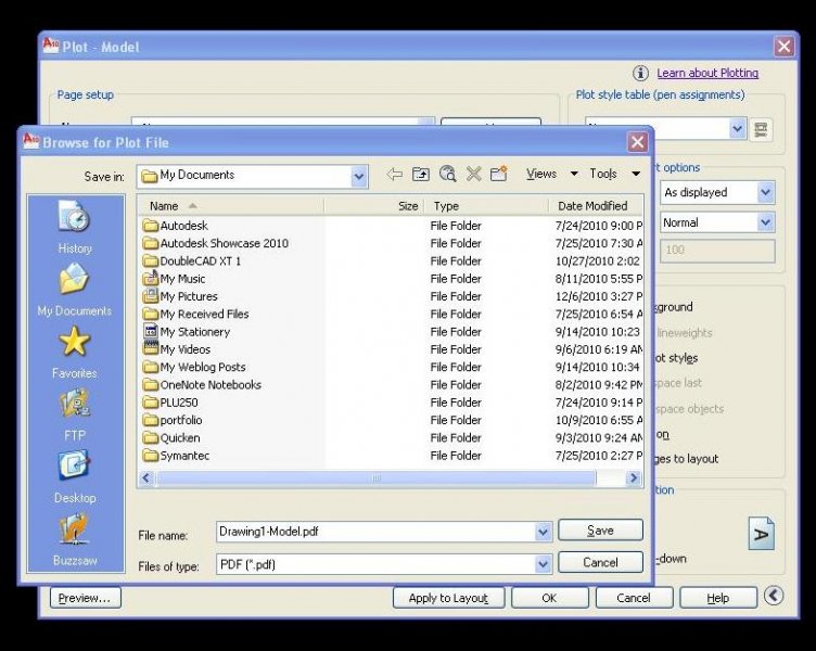

In 2010, when you select "Plot to file" and do whatever else you need to in the plot dialog, hit ok, and it pops up a dialog called "browse for plot file". This dialog gives you the opportunity to pick where you want the file to go.
When I Plot to File it does not ask me where I want to save/print to. It just print to a file and I want it to print to another.

when ever I use the dwgtopdf.pc3 file, a dialog always pops up and asks me where I want to plot it just like the dialog in the above picture, is this not the case for you? I dont think you can set it up to do both (plot to file and plot out).

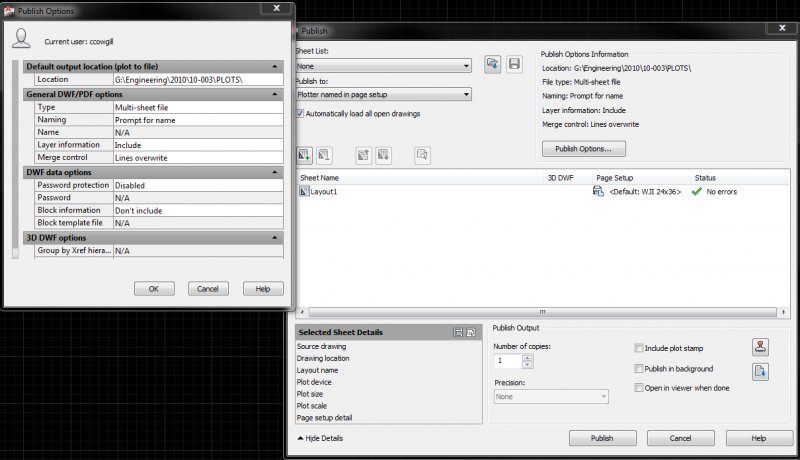

When I plot a single layout tab i get the dialog box asking me where to save to, but when I publish mutiable layout table it does not ask me where to save to.
How do I change that?
Thanks Matt
Ok, that clarifies. When publishing, there is a publish options that can be selected, this specifies the path for all the pdf files. If it is creating a single pdf with all the files within it, you need to set publishcollate to 0 instead of 1. Otherwise I think the publish options should do it for you.
