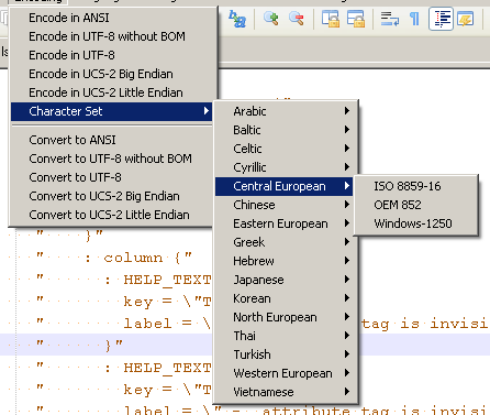

The Buzzard Posted December 7, 2010 Posted December 7, 2010 kruuger, What type of text editor are you using to write or save your code? Quote

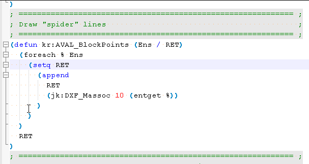

The Buzzard Posted December 7, 2010 Posted December 7, 2010 kruuger, Again I am going to ask. What type of text editor are you using to write or save your code? Can you please tell me? It looks like you are using a text editor other than Vlide or Notepad. The code posted has the format all messed up and looks garbled. Quote
Guest kruuger Posted December 7, 2010 Posted December 7, 2010 kruuger, Again I am going to ask. What type of text editor are you using to write or save your code? Can you please tell me? sorry The Buzzard i didn't saw your previous post i'm using Notepad++. So far the best editor for me. few keyboard shortcuts tricks below if you are interesting. kruuger Quote
Guest kruuger Posted December 7, 2010 Posted December 7, 2010 kruuger, It looks like you are using a text editor other than Vlide or Notepad. The code posted has the format all messed up and looks garbled. ok, i see the problem. probably i need to change encode. but which one to choose? Quote
Lee Mac Posted December 7, 2010 Posted December 7, 2010 Hmmm Notepad++ is OK, I use it for HTML/CSS but you can't beat the VLIDE for debugging One thing I have found with Notepad++ is that it doesn't seem to save my style preferences between sessions Quote
Guest kruuger Posted December 7, 2010 Posted December 7, 2010 Hmmm Notepad++ is OK, I use it for HTML/CSS but you can't beat the VLIDE for debugging yes that's true, i agree One thing I have found with Notepad++ is that it doesn't seem to save my style preferences between sessions my works fine I update the code. Now i should be clean and nice at VLIDE. kruuger Quote
