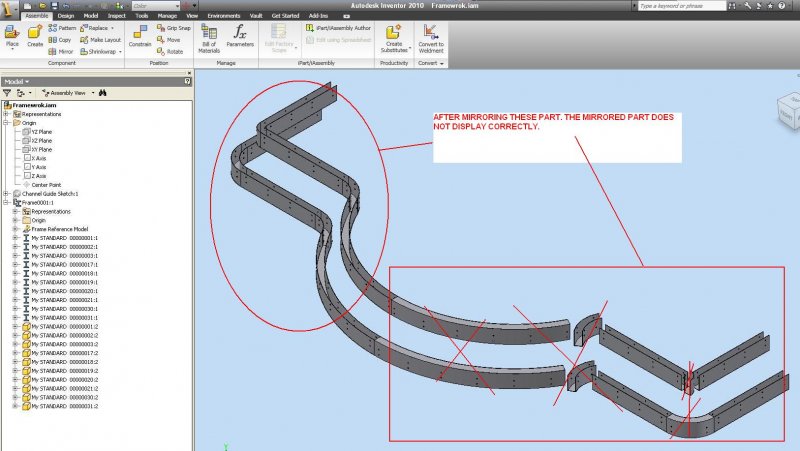

Hi Guys,
I have problem with mirror feature. It does not seems to be mirroring correctly. What could be the problem?
Please see image below and also I attached the .iam.
Any help is well appreciated.

Anyway, Base from the example image. Do these error occurs or its just a matter of users error...
BTW, I have created the channel and published it.

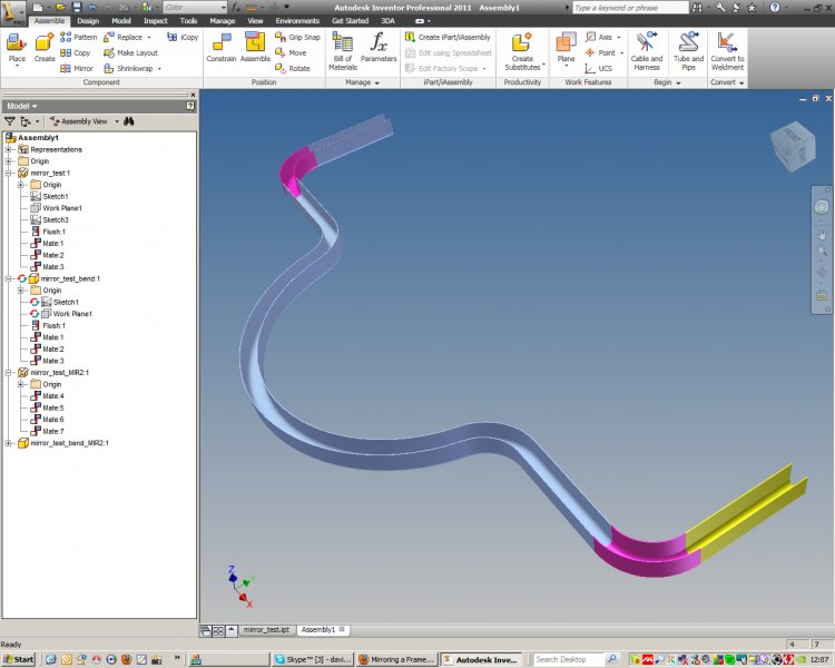

Willie, I tried to simulate your problem, but without success. My mirrored assembly is just 4 parts, but it proves to you that Inventor mirror works OK.
It will be interesting to see your files.

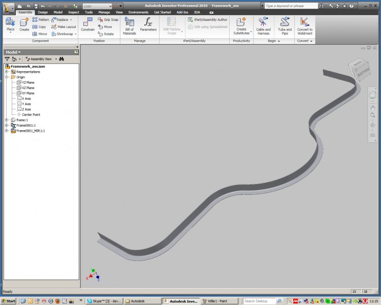

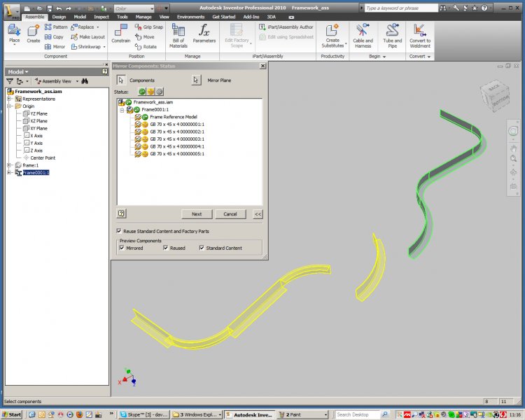

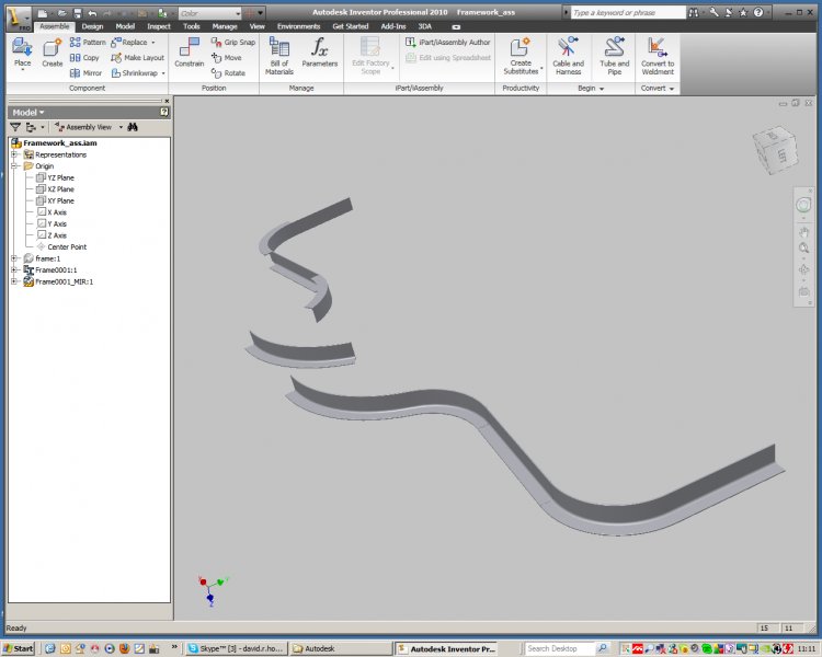

Hi Willie,
I have an answer for you.
The first attached image shows exactly what you got. The rest show how to cure the problem.

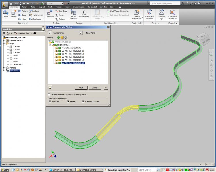

Firstly, when you select the framework to mirror, deselect "Reuse Standard Content Centre and Factory Parts."
Now select each part that you have mirrored (you can do them all at once) in the history tree and then click the green icon "Mirrors the selected objects" button from the top three. You will see the adjacent icon in the history tree change to match and your assembly will be correctly mirrored. Click next and then OK. Sorted!
Regards,
Dave

Hi Dave,
No worries about not realizing that I am using a frame generator. :-)
Wow, thanks for that solution it is indeed a big help...:D:thumbsup:
