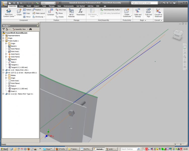

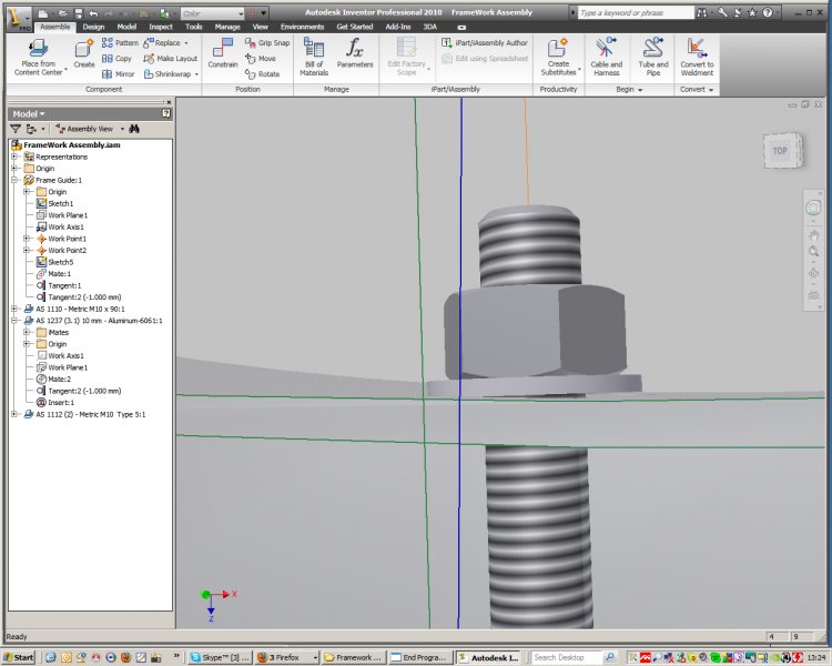

Willie, Inventor will never be able to come up with a viable solution to this, Your holes are not tangential to the curve.
Look at the first image I have attached and you will see that the blue line is at a tangent from the centre of the arc to the hole. The green line is a projection of your hole axis, which is clearly not tangential.
Image no.2 shows manually placed components and the result of this lack of tangency.
