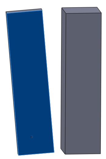

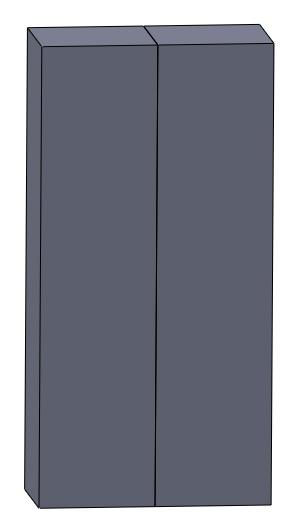

endlasuresh Posted December 14, 2010 Author Posted December 14, 2010 well i have designed die but i am nnot understanding how to make tool for this example their are two square parts of equal size but this are only 5mm width each.they will be placed sideby side exactly same height etc.now before molding this pieces have to move right and left.I mean the right side plate should move to right one and the left side should move to left. the place between two plates is also 5mm so the total space is 15mm.the above post you may seen the image it was a plastic component and ahve like this dimensions for the die. i will post image here what i was asking let me know if you still not understand. after molding the plates should move close to each other so the piece comes out.since in this plate their fills some plastic at bot sides. before molding the plates should move like this. Quote
shift1313 Posted December 14, 2010 Posted December 14, 2010 Im still having trouble understanding your question. Are you designing parts to be molded? Are you designing the mold? What parts are you molding? I think you are asking about draft angles but you are loosing me when you start talking about moving the blocks and tilting them. If you are trying to make a mold just post a picture of the part you wish to make and i will try to help you from there. Quote

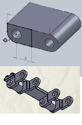

endlasuresh Posted December 14, 2010 Author Posted December 14, 2010 yes i am trying to move the blocks and this is inside die anyway the component i am posting again here.the second image is the component and have to manufacture this,but the die had already failed because of this blocks movement. Quote

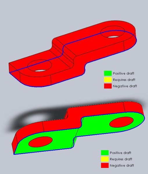

shift1313 Posted December 15, 2010 Posted December 15, 2010 The mold has to be in at least two parts. The part i uploaded is able to be removed from the die. I will take some screen shots of the draft analysis but in SW you can go to the Evaluation tab and click Draft Analysis. Pick a pull direction and enter a draft angle. That part was drawn with 1degree but i usually enter .5degree in the draft analysis. It will color the faces red, green and yellow depending on draft. Ill explain more tomorrow. Quote

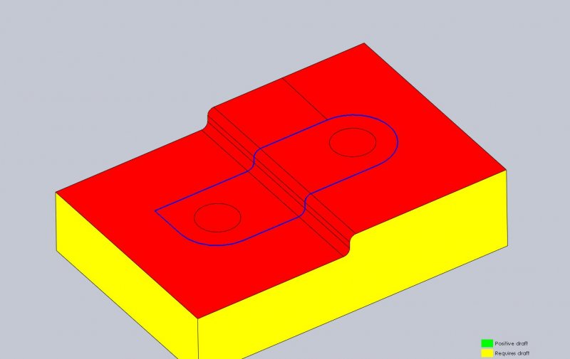

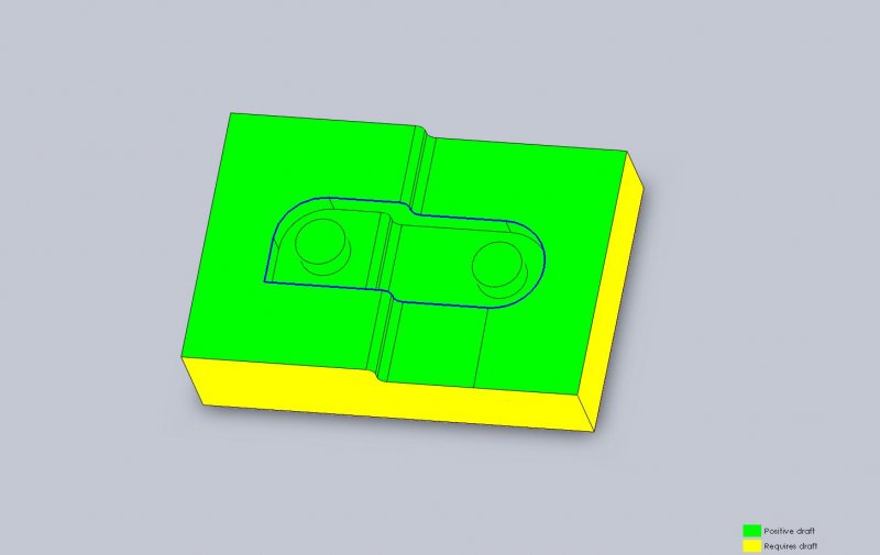

shift1313 Posted December 15, 2010 Posted December 15, 2010 Alright here is a screen shot of the part with draft analysis on. The blue line is called the Parting Line. This is the spot where both mold halves would meet. I drew this part so one half of the mold is essentially a shut off. The green and red show you positive and negative draft. The colors are based on the pull direction i specify. In this case it is perpendicular to the flat faces. You can see the bottom part of the mold is all red(negative draft). The top part is all green. If you go back through the features you will see how I extruded the first part, applied drafts to the faces in the direction I wanted to pull and then added fillets. The holes were extrude-cuts where i added a draft to them in the feature. This is an extremely basic introduction and i can't go into every detail but there is a lot of info out there about plastic part design. I did a quick search and came up with this. http://www.ironcad.com/download/ironcad/tutorials/PlasticDesign.pdf Its for a different cad program but it might give you an understanding. Here is some basic design considerations. http://www.efunda.com/designstandards/plastic_design/plastic_intro.cfm Quote
