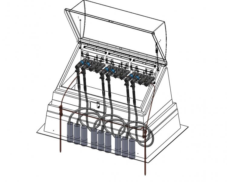

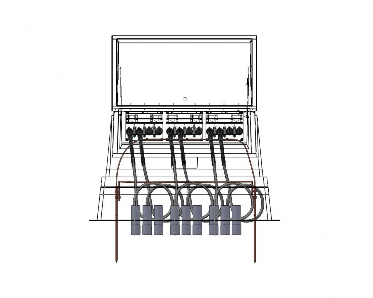

I am working on an assembly drawing and using Routing (electrical), and for some reason I am unable to suppress the 3DSketch line, so it shows up lightly greyed out on my assembly. I didn't have any issues with the other 3DSketch lines except for the one shown on the attached .jpg files. How can I fix this?!
If you go to View and turn off the visibility for Sketches and for Curves. That sketch will be consumed inside the Routing path part but turning visibility off at the assembly level should take care of it.
You are the bomb! That took care of it. Thanks!:D
No problem, keep in mind this hides visibility of all sketches. You can still see these sketches when selected or when editing. To find the actual cable it will be in the Route component in your cable assembly. Route1 if it was your first.
