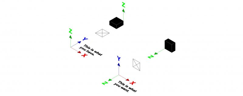

ReMark Posted December 13, 2010 Posted December 13, 2010 Maybe this will help. To the left is the default position of your UCS icon. Notice that "Z" is point up. I've drawn a rectangle and then extruded it to show you the results in both 2D and 3D. To the right the UCS position has been rotated. Notice that "Y" is pointing up. I've drawn a rectangle and extruded it to show you the results in both 2D and 3D. Does this help you to understand what is happening when the UCS is rotated? Quote
petteri Posted December 14, 2010 Author Posted December 14, 2010 Thanks this UCS helped me alot, ( rightup corner newucs button ) Final question abit offtopic but thankfull if i get answer How do i make floor to my polysolid object ? or any other drawings ? thanks alot u guys are super Quote
