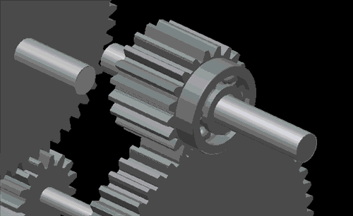

juansg Posted December 11, 2010 Posted December 11, 2010 (edited) Hi Everybody! I'm a newbie with Autodesk Inventor who has a problem trying to animate a gear reducer for a project at college. I've already made the system and it moves ok with the mouse. However, when I enter in Studio and animate the first shaft, I cannot get the rest of the components to move. I've been hours and hours trying to figure the problem out both in the program and on the web, with zero luck. I hope someone can help here. I attached all files (one with assembly, the other one with parts) in case it helps http://www.acro3d.com/reductora.zip thank you very much in advance Edited December 11, 2010 by juansg Quote

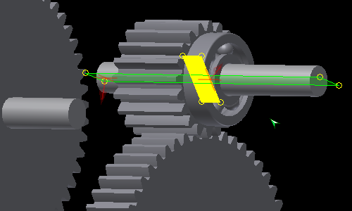

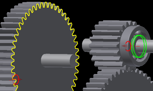

kencaz Posted December 12, 2010 Posted December 12, 2010 What I did was first add an angular constraint to the pinon gear: Then a rotational constraint for the bearing: (you'll want it to spin a little slower): And then animated the angular constraint and driving the assembly: Ken Quote
