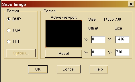

David Bethel Posted December 12, 2010 Posted December 12, 2010 The builtin rendering app in Autocad 2000 was really a weak application. I would not spend a lot of time with it. But if you have to, then the rendering menu has all the tools that you will need. You will need a lot of patience in applying materials and orienting them ( setuv ) in the correct plane. ( see how the middle piece is a cross section ). Accurender ( 2.0 or 3.1 ) was one of the better 3rd party addons that worked easily with autocad. There are a lot of stand alone rendering packages that can deal with dwg or dxf files. Use the SAVEIMG command to save the image as a raster file. DVIEW is going to be a friend as well. I use a autolisp program ( PXT.LSP ) for extruding meshes. Again 2000 wasn't much of a 3D modeler either. -David Quote
schuhfly18 Posted December 12, 2010 Author Posted December 12, 2010 There is a save file option but it only gives me very limited options as to what type of file - and even where I can save it to (I think that may be a result of such an old version?? because it looks like a very old style menu screen that pops up). What I've done in the past with all the 2D profiles is I saved them as a dwg file, which I then opened in Illustrator to make a few minor adjustments (adding the watermark, adding the profile number) & save as jpgs and tiffs that I could transfer online. Quote
David Bethel Posted December 12, 2010 Posted December 12, 2010 It should allow BMP TGA of TIFF. I would definetly recommend TGA format. It is a lossless image and can be used by most decent photo editors. The drawback is that your limited to screen area size. So you are pretty limited in high res images. Once you select OK, you should be able to save file anywhere on your system. -David Quote
