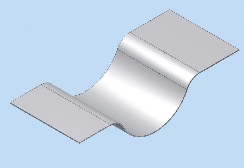

rdharvey Posted December 13, 2010 Posted December 13, 2010 i have produced a sheet metal clamp but for some reason it won't let me add corners?? also once i have done this how do i produce the flat pattern?? Also the attatch file box keeps saying its an invalid file!? any ideas why?? Quote

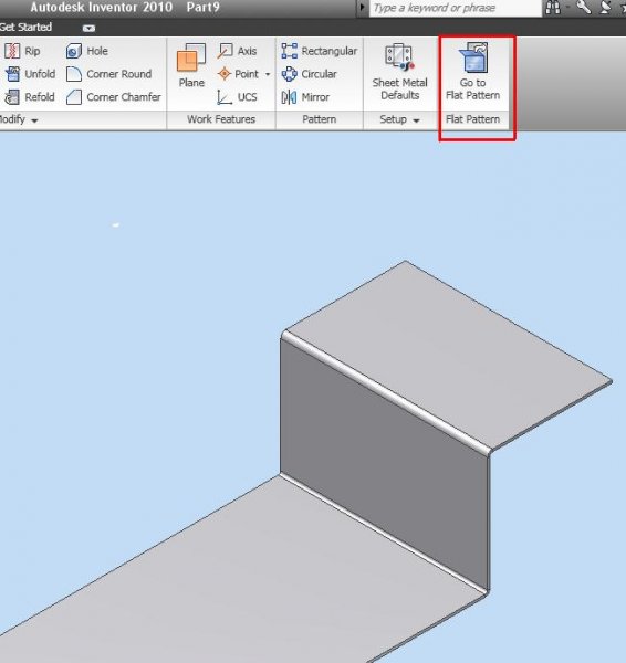

Be_cool Posted December 13, 2010 Posted December 13, 2010 Just click icon to go in flat pattern mode... Can you attach image of the clamp? Quote

rdharvey Posted December 13, 2010 Author Posted December 13, 2010 The flat pattern button isnt there for some reason :/ Quote

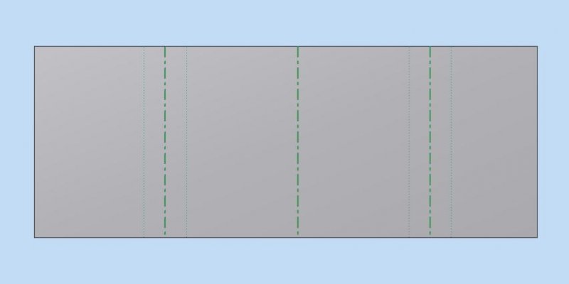

rdharvey Posted December 13, 2010 Author Posted December 13, 2010 ok so i have selected the flat pattern. but the part doesnt go flat. do i have to change any parameters of the model or anything? not used the sheet metal much :/ Quote
Be_cool Posted December 13, 2010 Posted December 13, 2010 Just draw contour of your clamp and use contour flange tool...deffine thickness before, and that's it. Regards Aleksandar Quote
rdharvey Posted December 13, 2010 Author Posted December 13, 2010 awesome! it works thanks dude! Quote

Hopinc Posted December 13, 2010 Posted December 13, 2010 Hi Guys, The reason Rob could not unfold his parts is that he had not set his "Sheet Metal Defaults" to match his chosen material thickness. Inventor could not therefore work out a viable solution. For anyone else having a similar problem make sure that these parameters match. If you are not using the system default material thickness setting, simply untick it and put the material thickness in the adjacent box. Regards all, Dave Quote
