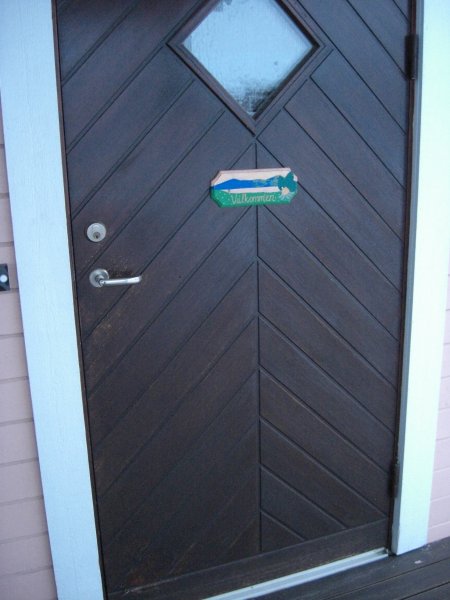

Kobbe Posted December 13, 2010 Posted December 13, 2010 Hello! I am useing autocad 2011 and are trying to get painted wood. I want to be able to see that it is wood that is painted. Like white paited wood. How do I get a really dark wood, like oiled wood. Here are an example of both. Quote
ReMark Posted December 13, 2010 Posted December 13, 2010 In other words you still want to see the wood grain show through the paint much like if it were stained? Quote
Kobbe Posted December 13, 2010 Author Posted December 13, 2010 in other words you still want to see the wood grain show through the paint much like if it were stained? yes That is exately what I want. Have tried the material editor in Autocad 2011 but I can't get a stained/painted material that looks good. Quote

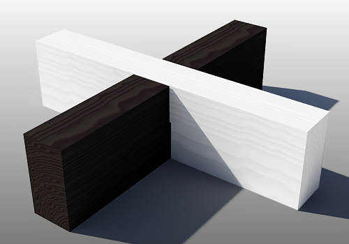

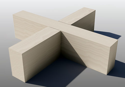

fahim108 Posted December 14, 2010 Posted December 14, 2010 In AutoCAD 2008, I go to the Materials flag (type in MAT) > create New Material > name it > and apply the following settings... Material Type: Advanced Specular: 0,0,0 (Black) Map Type: Wood Then under Map properties, I assign: - Color1: 179,155,128 - Color2: 167,140,114 - Radial Noise: 1.00 - Axial Noise: 0.50 - Grain Thickness: 0.10 ...which gives me this - Further, you may play with the color settings to get a color of your choice; like: Map properties (for darker block): - Color1: 14,12,11 - Color2: 9,7,7 - Radial Noise: 1.00 - Axial Noise: 0.50 - Grain Thickness: 0.10 Map properties (for lighter block): - Color1: 255,255,255 - Color2: 230,230,230 - Radial Noise: 1.00 - Axial Noise: 0.50 - Grain Thickness: 0.10 ...would give me this - I have no idea if the procedure is still the same for the newer versions as well, but I thought I'd contribute! Tip It is always a good idea to make two (duplicate) textures for a material like wood, as it is based on axial mapping. If you observe closely, here the Axial Noise of the left block is along the X-axis while that of the other block is along the Y-axis. The origin for both these noise(s) is always taken at the 0,0,0 WCS, unless you convert it to a block. Hope that helps. Quote

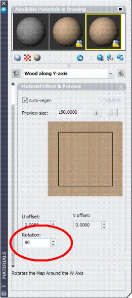

fahim108 Posted December 23, 2010 Posted December 23, 2010 Sure guys, here's the 3D file. Axial Noise.dwg I couldn't find the original one, but never-mind... I redrew it! @ Kobbe: It's simple; create a copy of the original material and rotate it. Here's what you need to change... @ Oppie: Yeah mate, creating textures in AutoCAD is great. You don't need those low-resolution-free-textures anymore... cheers. Quote
