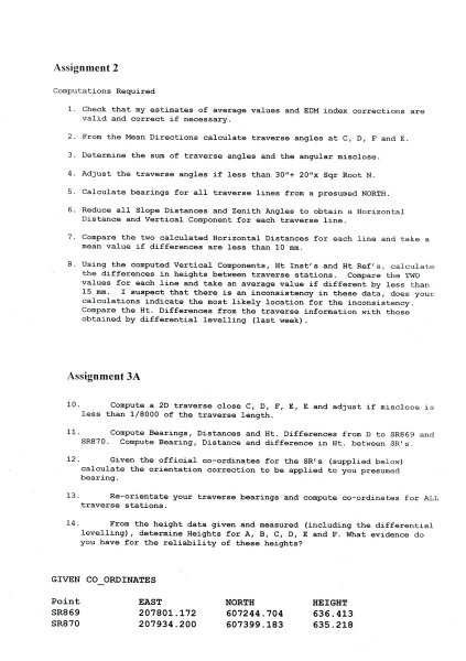

I have attached the Assessment outline including the accompanied data sets:
Do you want to enter the known coordinates and raw data (HA,VA,SD) into Civil3D and create a traverse using example problems? Or will you be using an instrument and data collector to collect survey data? If you're using a data collector then look into FBK files (fieldbook files).
Greetings,
The former of the two options that you have provisioned is the one I seek, preferably inserting raw data into AutoCAD Civil 3D in order to produce the traverse and subsequently derive an adjustment via ‘Mapcheck’ function from what I understand.
Thus far I have managed to derive a solution in terms of identifying the error within the system and hence appropriating it albeit I am uncertain as to how I might be able to determine height differences. It has been suggested that I employ the point marker utility and create a surface template in order to evaluate the data.
I apologize for any misconception upon my behalf, as I am enthralled with a vast array of software, to be quite honest 12d is preferential although Civil 3D is limited to the parameters of this current course.
P.s. Is it possible to insert the data into an excel file and redistribute to Civil 3D?
I dont think you need MapCheck for what you're trying to do, yet. You need to create a Survey Database. What kind of data collection software are you using?
