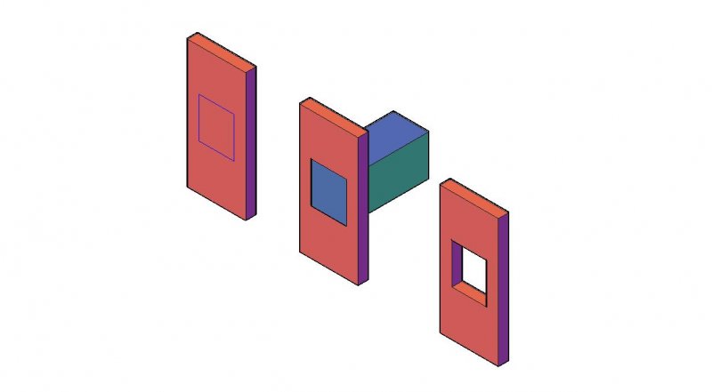

You can also create a rectangle sized to the opening you wish to create on the face of your wall then use the PressPull command to punch a hole through the wall.
Opening created using the PressPull command.

I have put the cut through on the wrong place, i just need to slide it along the face of the box
Use the Move Faces command. Watch your picks. AutoCAD may want to work on non-related items which you can "remove" using the "R" option. You just want to move the opening not the entire wall. I suggest you also enable Orthomode and use direct distance entry to be precise.
